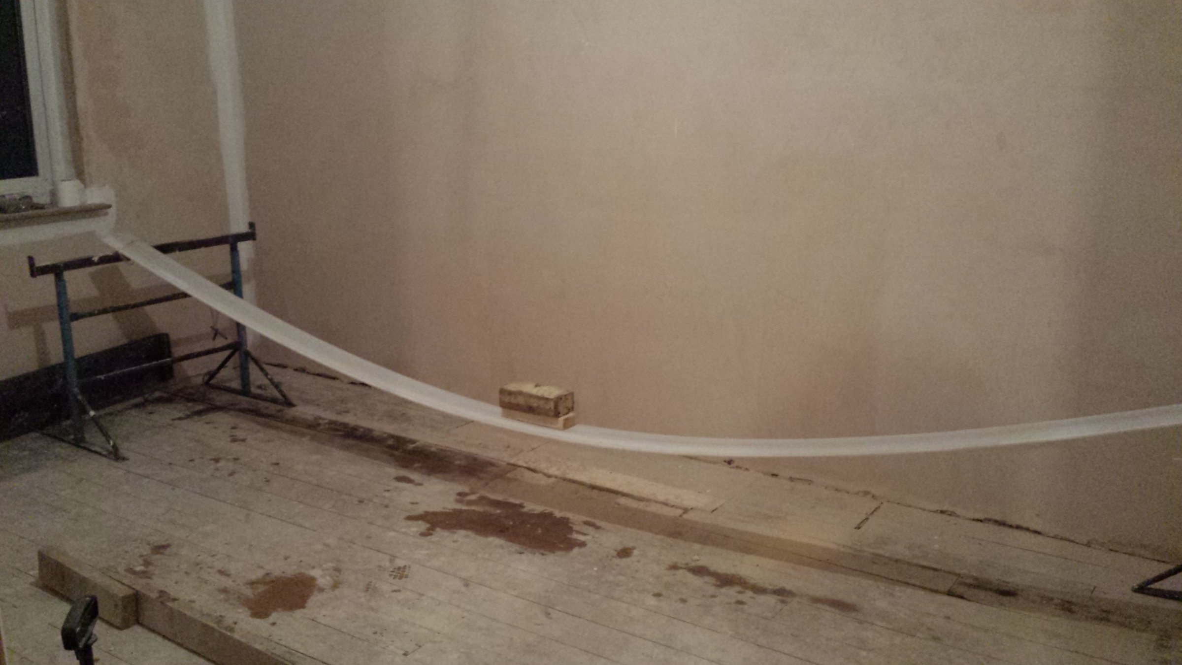

Hi Jobandknock and ladylola,
Thank you for your reply its a real help here. ive taken the plunge and started the process, I'll update on here as i go along.
Ive sprayed the skirting board with water, i should have completely soaked it but only just saw your reply. Will leave it over night to see what gravity does. Tomorrow I'll completely soak the board with a hosepipe and repeat the process with a few more bricks.
ladylola - steaming the MDF sounds like a good idea, i've got a steam wallpaper remover i may use that aswell as soaking the board. Out of interest how long did the steam process take?
Ive attached a pic
I can't say for definite but I seem to recall it was all done in a day , the job being two circular bays. Must have done a decent job as I was then asked to form some architraves around a porthole window. I seem to recall steaming the timber until it was almost too hot to hold then applying force . I used a couple of short vertical scaffold poles attached to the larger scaffold.
