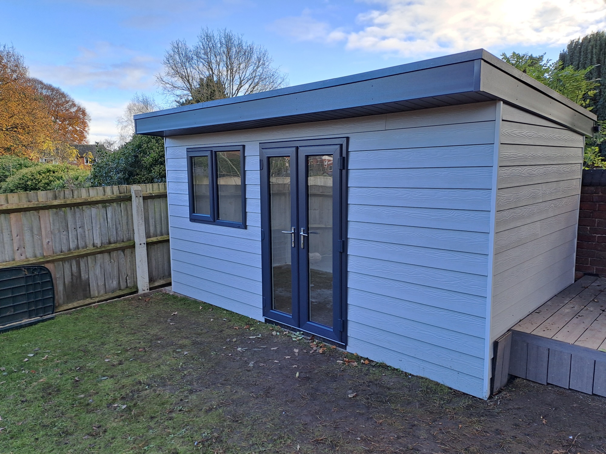

When I built my shed (on concrete slabs), I laid a DPM on the slabs fist. This DPM extended past the edges of the slab by 600mm on all sides. I then laid out the timber frame base for the shed in 75mm x 50mm timber (laid flat), to the perimeter of the shed only. I infilled the 'frame' with 50mm Celotex insulation. I laid the ply floor onto the frame and insulation. I then erected the sides of the shed in 75mm x 50mm timber. I then wrapped the additional 600mm of DPM up the sides of the shed before cladding.
