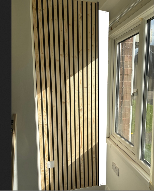

Hi all,
Just in the process of completing a slat wall but have ran into an issue with the final slat - as you can see from the attached picture, the gap at the top is a lot wider than the gap at the bottom. The slats are perfectly straight but the window/wall is not. (1930s house)
Whats the best way to finish this? Do I scribe the wood, or cut the whole length the same width and use filler for the gaps either side? Just can't visualise what would look best
Many thanks

Trouble with these things is people only see them online with nice square walls, really needs thinking about before you start banging the slats on the wall. I think I would have done the bit next to the window in plasterboard or timber and also would have reduced the gaps down a bit to end with a full slat at the top. Bit like this:

Strangely I didn't have a problem with the left hand side at all, so just cracked on with the right.
Is there anything else I can try to make it good? I don't mind starting again, I can probably salvage most of the wood but not so sure about the wall underneath so want to avoid it if I can!
Cheers
Just rip a batten the right shape for the last one, bit of a faff to cut but it’s done then.
I’d just measure width top and bottom and do a straight cut, unless the wall is really all over the place. Leave at least a 10mm gap to the wall, to give you a bit of tolerance.
Dead easy and quick if you’ve got a plunge/track saw.

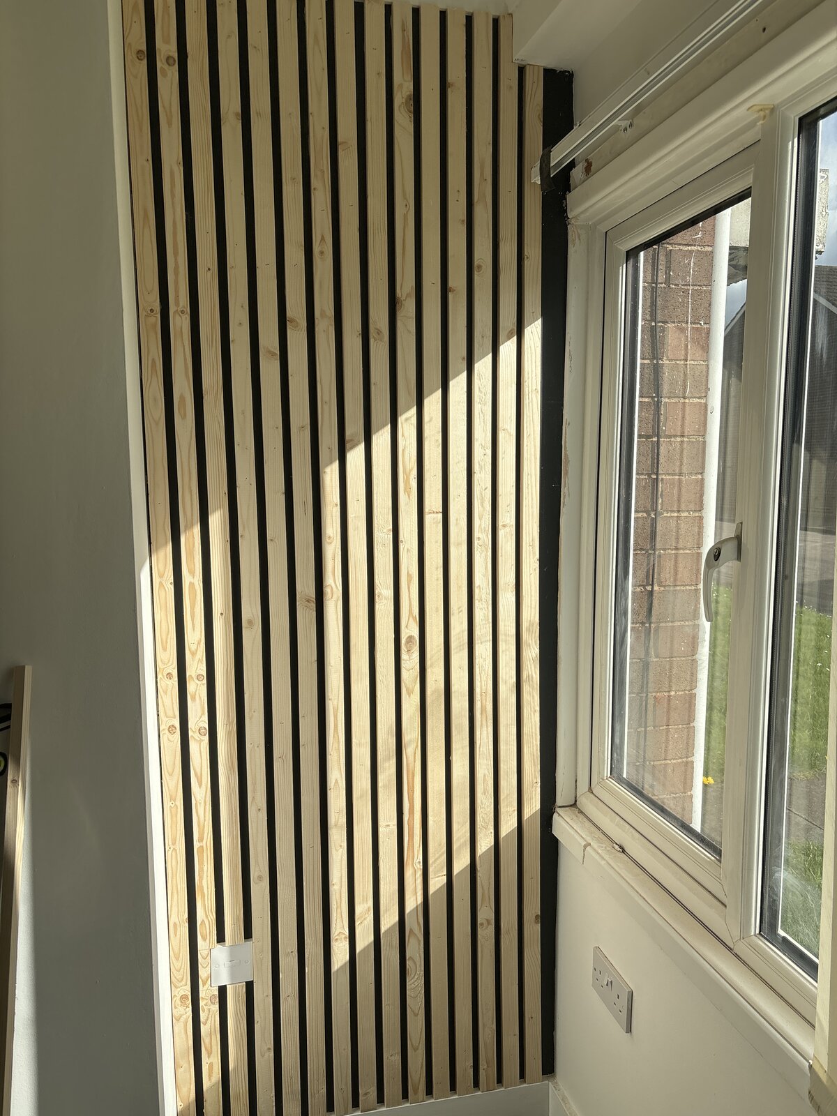

The only thing I'm concerned about is a batten wider at the top might accentuate the fact that it's not level, but I suppose my only other option is to cut it the same width top and bottom (which leaves me with a 45mm ish gap to the window in parts) and then use some kind of filler. Not sure which would be easier on the eye though
I’d just cut the piece and see how it looks. Personally I wouldn’t do anything involving filler.
Is anyone concerned that the external wall is 50mm out of plumb?
I looked at that and was guessing the external wall would be relatively plumb and the internal edge wasn't plumb!
Going by his spirit level in the corner.
