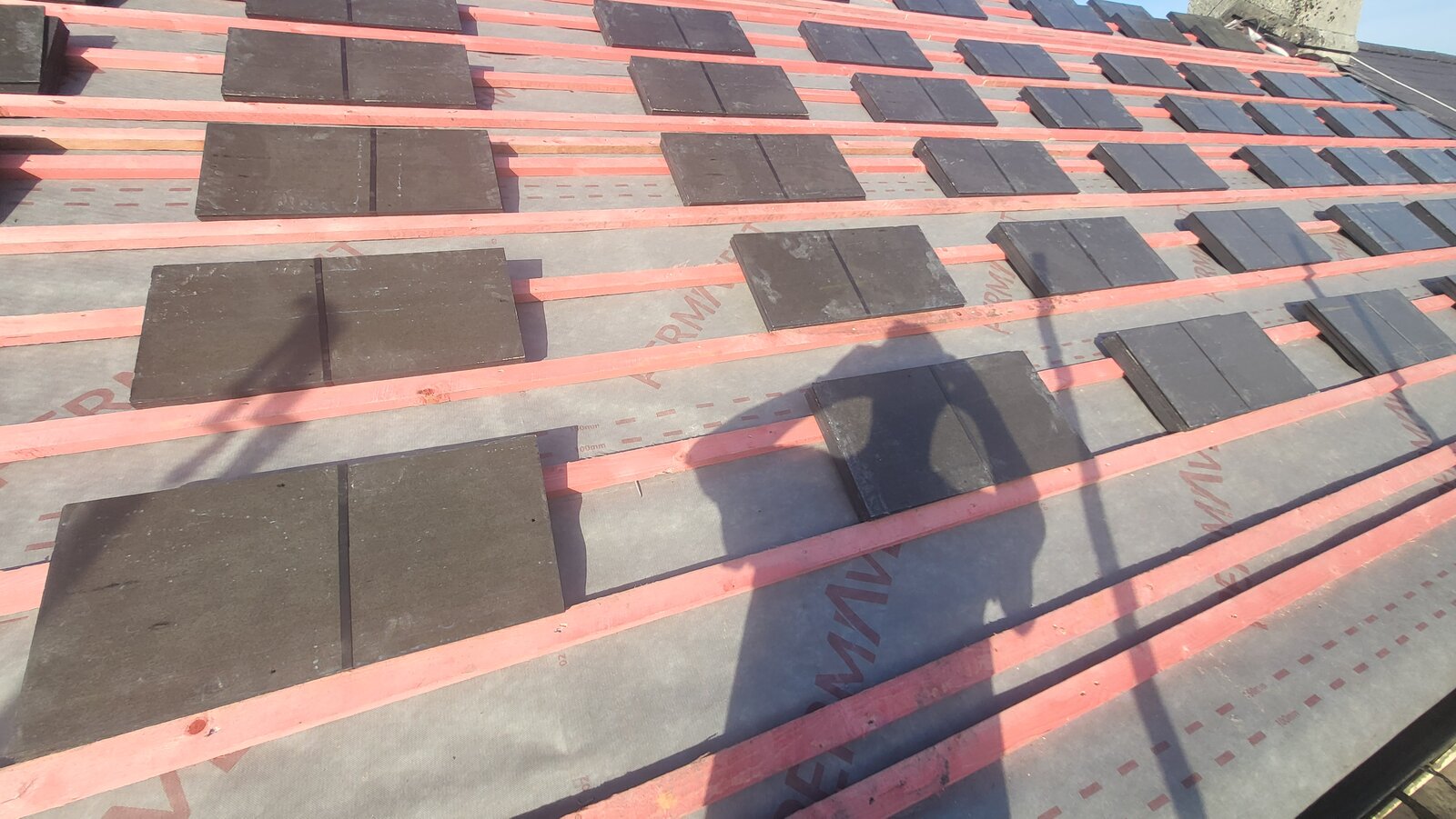

My partner and I recently purchased our first home in South Wales. It's a 1930s build with a welsh slate roof. I don't know how old the roof is but it could potentially be as old as the house. The survey flagged up that the underfelt and battens needed replacing and we had several quotes to do this. Two of them told us that they existing slate roof would also need replacing and suggested using fiber cement slates instead (my first regret is that I did not do more research into this claim). We decided to go with one of these roofers who was offering to do the work at a very reasonable price.
The roofer started Monday and called me up to say that he's changed his mind about the fiber cement slate and thought a conrete tile would be better for the roof. I was busy at work at the time and trusted that he was the expert (my second regret).
The tiles arrived today and I did some more research and realised that planning permission would be required to change the tiles from slate to concrete and that we should have had a structural engineer assess the suitability of the joists for a heavier roof. I called him this evening and told him this, and he has agreed to send the tiles back and go with the original plan to replace them with the fiber cement slates which weigh about the same as real slate. That's fine, but I also noticed that, while he originally told me that the original Welsh slate could not be salvaged, the workers have neatly stacked around 90% of the slate tiles on the scaffolding, fully intact.
My concern is that I've been lied to and that this slate is in fine condition to reuse. It seems obvious that he intends to sell it on. My plan tomorrow is to go ahead with the fiber cement slate, as that's what he's quoted us for and I don't trust them to have the expertise to install real slate, but to ask them to leave the real slate on site. That way, I can either sell it on myself or get a different roofer to reinstall it later. As far as I can see, he can't take issue with this as, if the slate is too poor to reuse (as he has told us it was) then I'm saving him money scrapping it.
Am I being screwed over? What do you think the right move is from this point?

I think we've decided that when he turns up today we're going to agree to the original deal of replacing with fiber cement slates for the 25 year guarantee, but inform him that we're keeping the slate. I've got half of it down off the roof already so salvaged a couple of grand already.
If he kicks off, we'll send him on his way and find someone else to fix it.
Update with a picture of the slate I've salvaged from one half of the roof so far.
Roofer has agreed to go with the lightweight fibre cement slate and let us keep the slate coming off.
When I told him we wanted it he was clearly caught out and started talking about putting it back on and that we'd need to buy loads of extra reclaimed slate which cost "a lot".
I don't trust him to give us a fair price on this or do a good job with it so I told him I'm happy to go with fibre cement slate but to keep all the good slate in case we change our minds in future.

The other half are already off just sitting on top of the scaffolding. I've told them to leave them there and I'll get the rest down myself this evening. He seemed a bit flabbergasted but I reminded him that he'd told us they were of no use so I'm happy to save him a job and take them off his hands.
They have lots of great reviews on Checkatrade but I'm aware that doesn't necessarily mean anything. Obviously I don't really know what I'm looking at but on inspection while I was up there, the job they've done so far looks professional.

Please take photos of the work, ideally before any slates start going on and post on here as it goes….I don’t know enough to spot errors but there are some really experienced roofers on here that pick up errors instantly.

My plan is to get the fibre cement slate roof as originally agreed and keep my slate to restore one day when I have the money to pay an expert.

Here's the roof currently for anyone interested. I've got all the original slate safely stored away. From what I can tell 95% of them were in immaculate condition and we even had some spare in the garage. I reckon we would have only needed to source 30 odd new slates, so he's swindled himself out of an honest roofing job and he hasn't even ended up with the slate he wanted. I'm trusting the fibre cement slate to at least do the job for the time being, just want them gone now.
