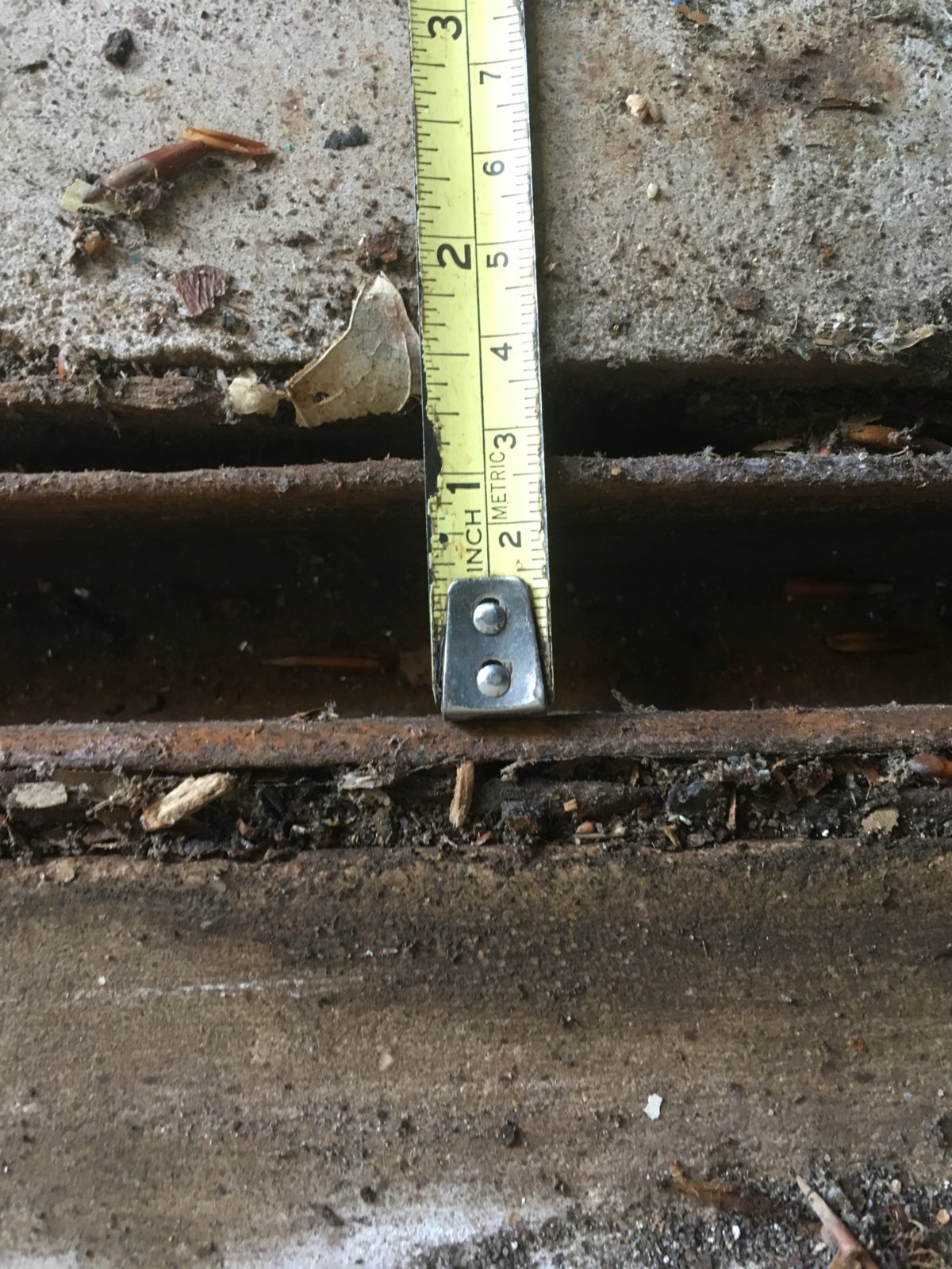

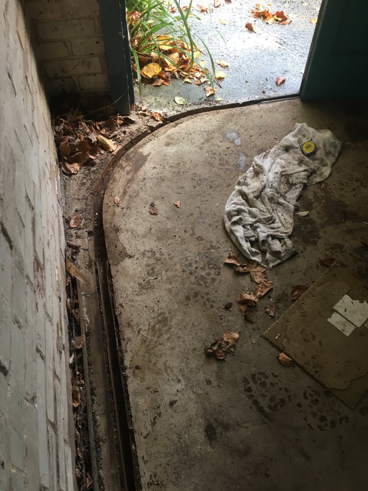

I am trying to help my Father in Law fix his sliding garage door. It is a large sectioned wooden door hung on rollers with locating lugs at the bottom of the lower hinges running in a curved metal channel embedded in the garage floor.
The curved element of the bottom channel has rusted away (see pics). I hope to manufacture and fit a new channel replace the curved bit.

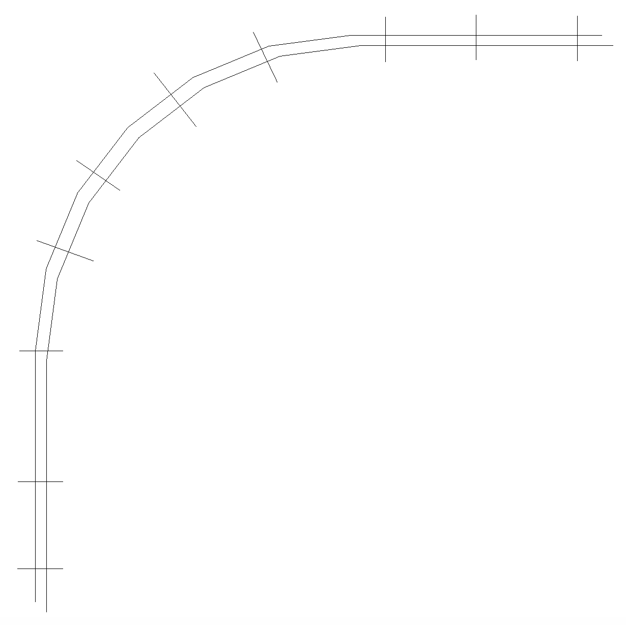

In order to get the curve right, I am planning to drop a plumbline down from the centre of the top rail and draw the resulting arc onto a sheet of OSB. I will then glue and screw 24mm wooden dowels to the OSB on the centreline of the required channel (about 6 inches apart). I am then going to clamp two 2.5m lengths of flat steel (2 or 3mm thick and about 4cm high) either side of the dowels to form the required curved channel. Under the two steels, I will place short lengths of the same material, which I will then weld to the bottom of the curves in order to ‘fix’ the correct shape.
I will then screw the channel in the floor and concrete upto the edges.
Some questions please:
  1. Does this sound like a sensible approach?
  2. Will the welded steel tabs actually hold the curve in the correct shape, or will there be any ‘bounce back’?
  3. Any thoughts on the spacing of the tabs (or the dowels) to actually hold the shape?
  4. Is 2mm / 3mm steel going to be man enough for the task?
  5. Is it worth rust proofing?
The drawing below hopefully helps to explain.

Your faceted approach seems feasible but there’s a good chance the rolling feet on the door would tend to jam unless the internal curves were pretty smooth.

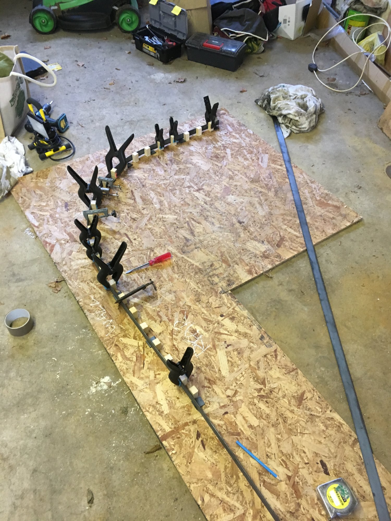

This is exactly what I am intending to do, but I am planning to just form the curve by bending the bar around the wooden dowels and clamping it in shape while I weld the bottom bits on.
I think I am going to use 30 x 3mm mild steel bar for the two sides (and short lengths of the same size for the base).
Will that be possible to bend by hand and clamp? The curve is not particularly tight (90 degrees over roughly 1500mm).

My concerns are that you’ll get a curve consisting of a series of flats, and I dont know how well the door would slide along this.
Either way, I’d construct a full size timber template so you could tell how well the bending is progressing.

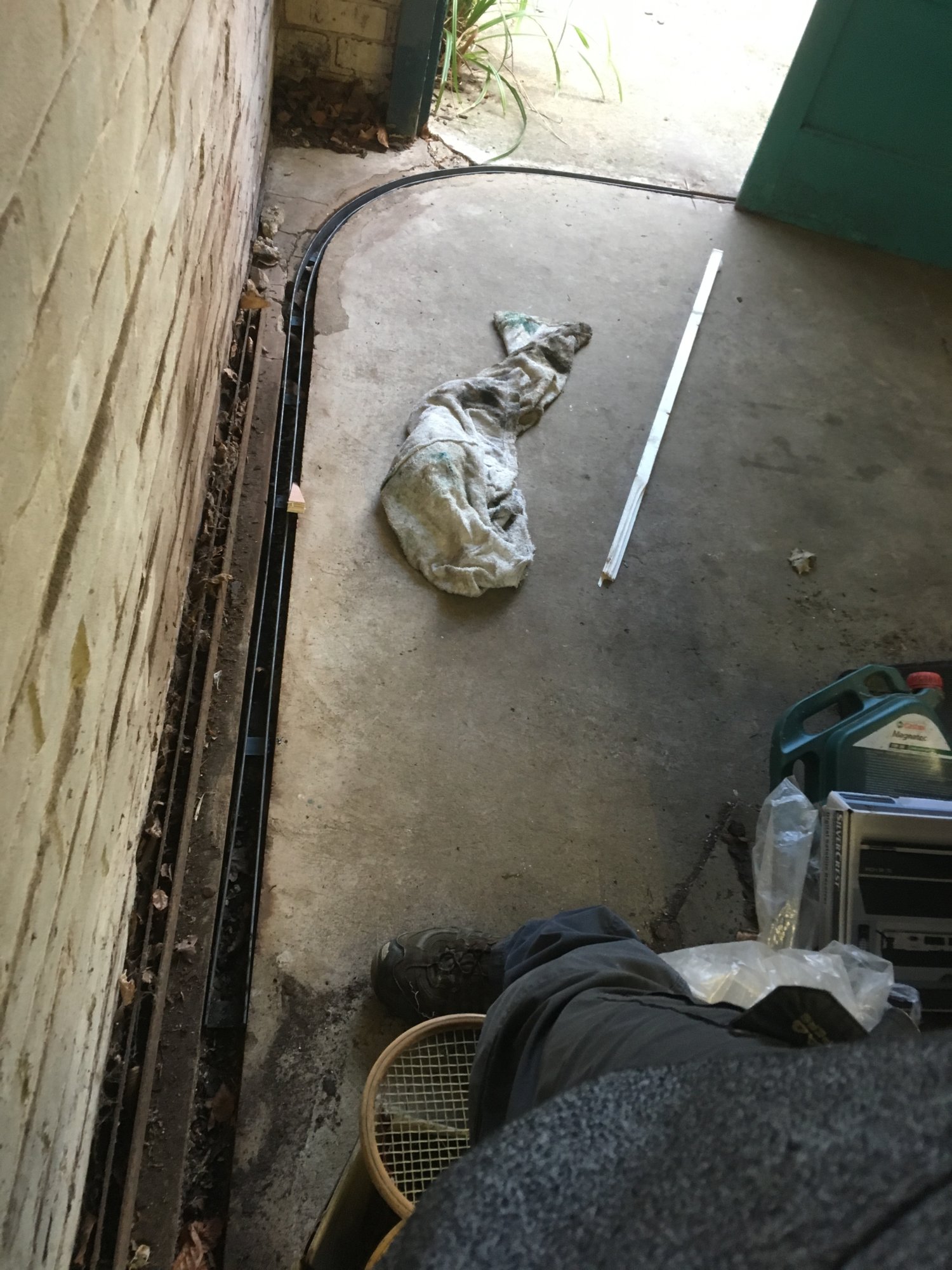

Just a quick update in case anyone is interested. It has taken a while because I only go over there occasionally! The bending and welding was actually very easy and the new track fits fairly well in the original slot. I just need to do the final 'joining' welds to connect the new to the old metal and then mix up some fine concrete for the small gaps around the outside.
The former and clamps prior to welding.
In situ waiting for final welds and concrete.
I'm quite pleased with how this has worked - Total cost, about £50.

How did you get the bends so smooth? It looks like 3mm flat bar from here?
John :)
Thanks. Yes 3mm flat bar with the offcuts used as the tabs welded to the bottom.
It actually bent really easily and I used quite a lot of pegs with a small distance between them to get a good curve.
