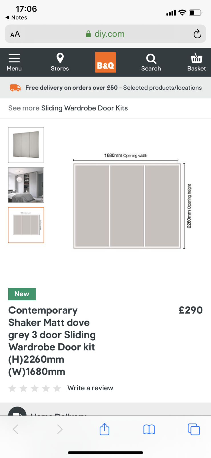

Hi all

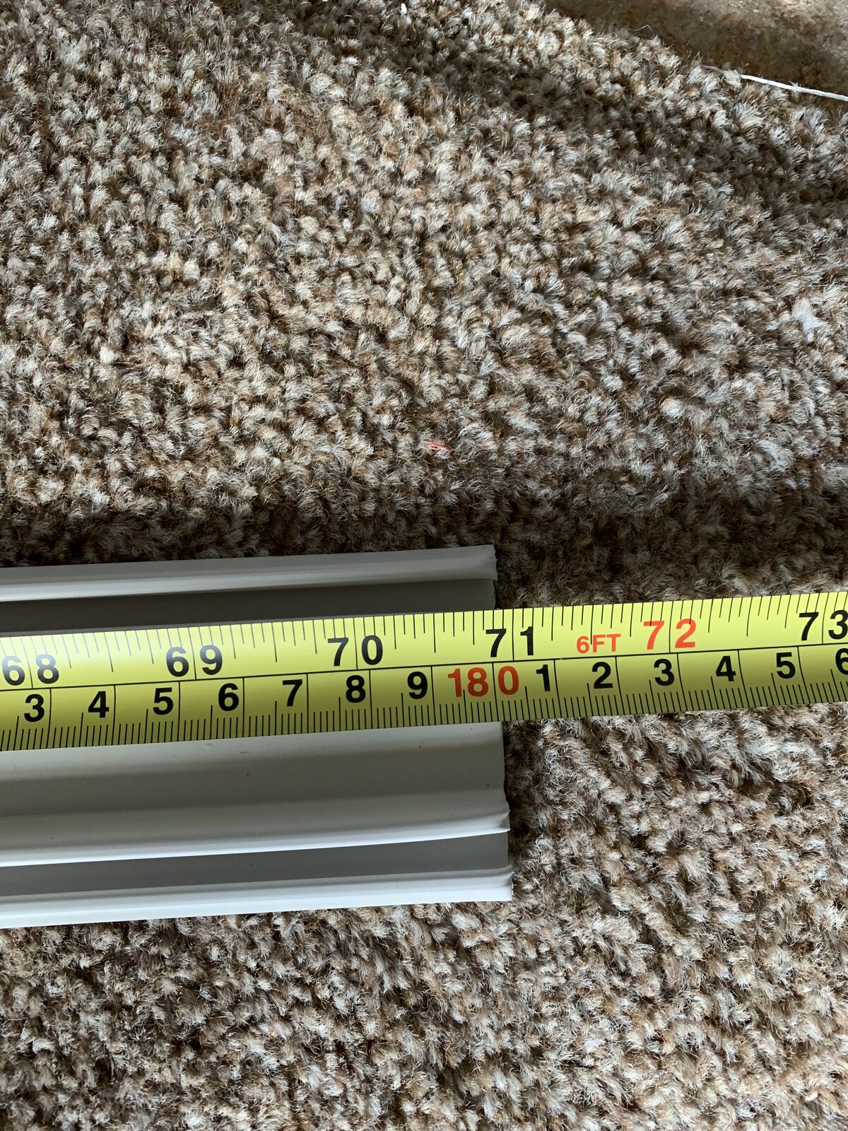

I have received the doors, and they don’t seem to be the right size. The description (see photo) shows it’s 1680mm wide at open width, yet the sliding door frames top and bottom are 1800mm long, which won’t fit in my available space!
Any suggestions on what to do, could I cut the sliding kit to size as the doors should still work with less space?
many thanks!
you need an overlap off the doors so looks like 2" overlap on the doors and maybe 10mm overlap at the ends against the walls giving you the 120mm discrepancy ??
The runners are always longer and are cut to length.
I thought this would be the case! The gap I have available is 1698, am I right in saying the doors will still be okay considering there are 3 x 610mm doors, knowing that they will slide?

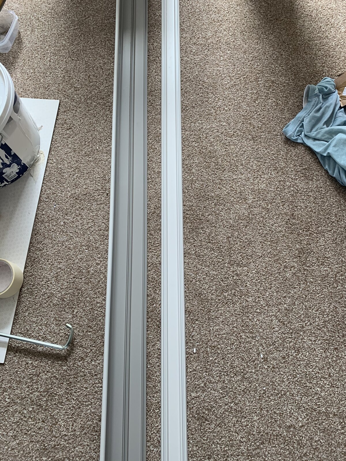

How many tracks do you have?
If you're lucky- 3 so 2 doors can hide behind the first
More likely - 2. So one at each end and one in the middle, bigger than the gap
Here are the tracks, so I’d say two? On that note, I assume the left of the two in the picture attaches to the ceiling?
