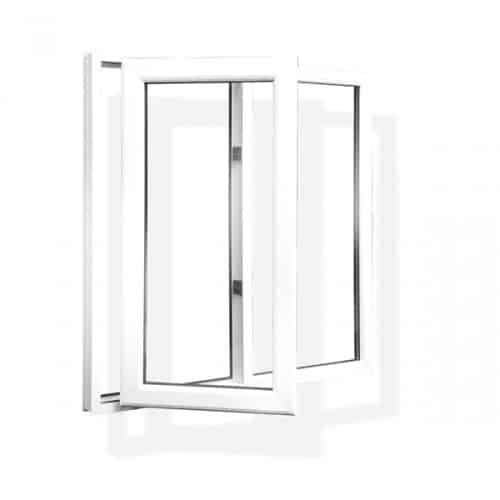

When you say 'casement' do you mean like this eurocell modus system?
Well, it wouldn't be that colour, just white.
Really, what I mean by casement, is just that they aren't sash.
Just something like this Rehau 70mm frame.
http://www.hartwindows.co.uk/wp-content/uploads/2012/06/REHAU-Edge-Window-600-500x500.jpg

All the Rehau profiles can be fabricated in either a 62mm or 52mm slim outer frame. The one pictured is the slim outer frame (52mm) used mostly on A Rated windows. We supply and install Rehau, please message me if you require any info
