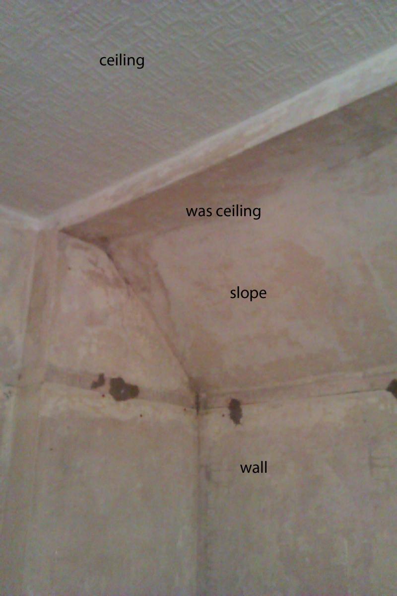

i am papering a bedroom and at one end of the room the ceiling slopes down, i am going to paper this as if it was the wall i.e. just going from floor to ceiling with the wallpaper, my question is should i try to hang the paper in one go or should i treat the places where it goes from vertical to the slope as a corner i.e. go round slightly then over paper, if i do this i have the added problem of trying to match the pattern. not sure if i have explained it very well but hope someone can understand

i have done a profile drawing of the wall so that you can see my problem

I think I get it. The drawing is the wall you want to paper.
I would do the top vertical bit and the horizontal bit in one piece of paper.
And the remaining, lower section in another piece of paper.
I would do the larger, lower section first, ensuring the pattern is level with any other walls you have papered.
I would then do the top section, again ensuring the pattern on the short vertical bit is level with any other walls you have papered.
Obviously the pattern won't match at that internal corner near the top, but that doesn't matter at all.

Theres only two ways to tackle this. One piece or sparkwight's suggestion.
I would try this in one piece. This will ensure the pattern matches. Just make sure you use plenty of paste and spend more time than normal brushing the paper to ensure you have full contact will the walls in all places.

I think trying to paper round that lot in ONE PIECE could be proplematic, as the corners and bends will no doubt be out of true and the paper will end up crooked and badly fitting.

Why not paint the 90 degree angle in with the ceiling and paper the rest?
ok ive taken a pic to try to explain the prob, although my drawing isnt great it does look like a profile of the room, anyway hopefully the pic will show it better, it doesnt matter about the type of paper, actually its viynl but all im afetr is a bit of help with how to hang it, 1 piece.....so many corners to go round it will run out, more than one piece .......how then do you match the pattern without the jjoins showing up, i cant believe that this is such an unusual situation.
