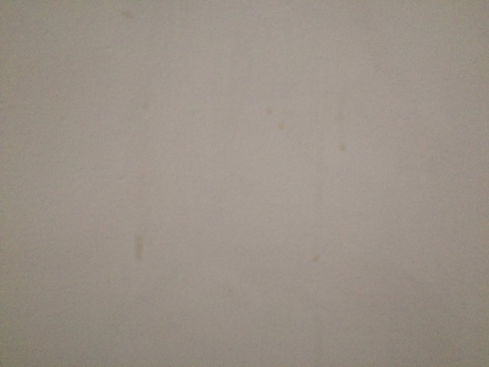

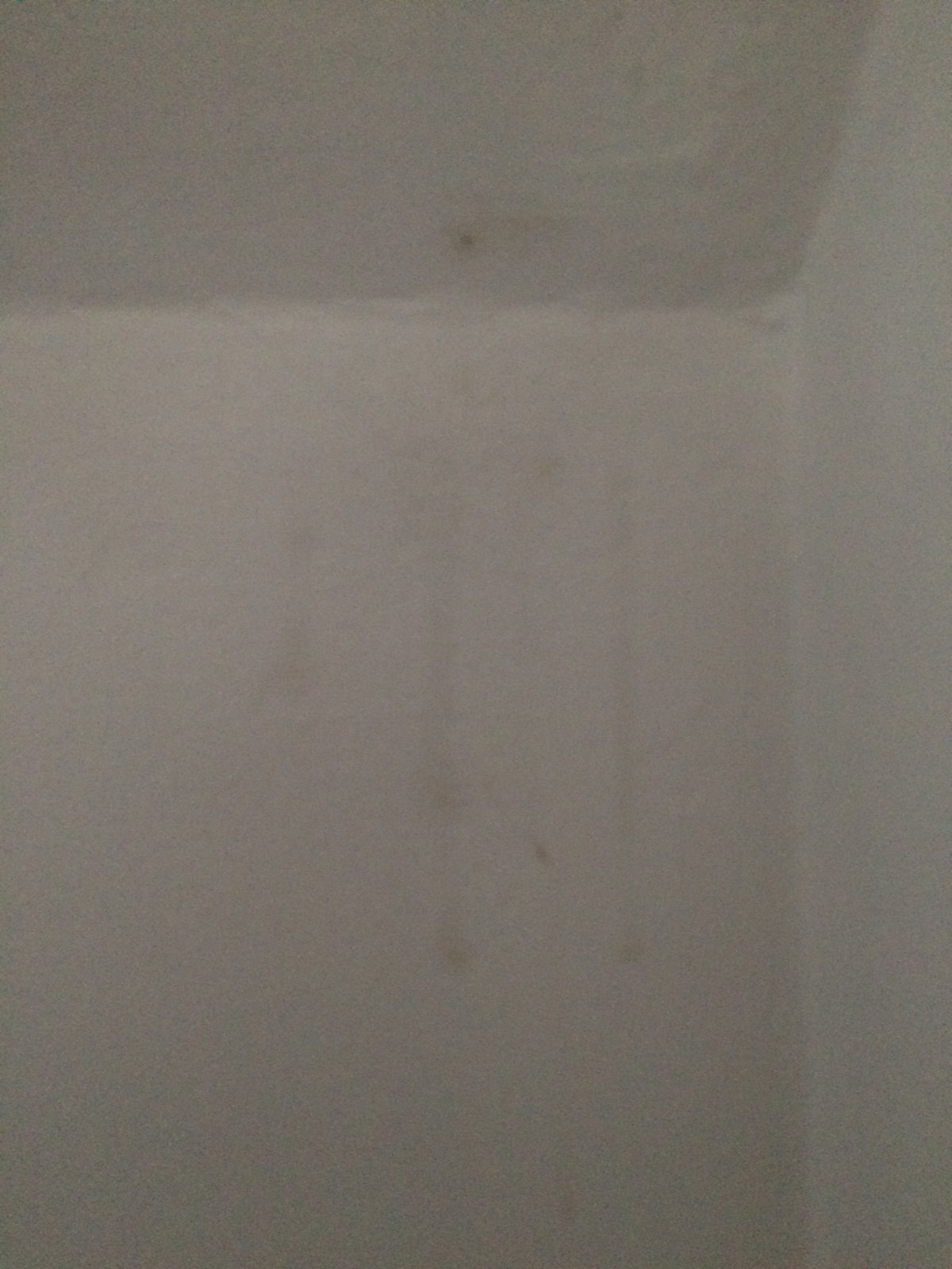

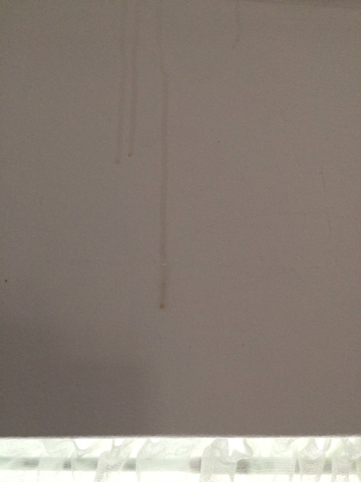

Hi everyone, would be good to get your thoughts on this - we decided not to add the extra vents and the loft is very airy and breezy, not ofthe other neighbours have had a problem.
However one week after soffits replaced some sticky residue drops / water marks have started trickling down the wall - is this a leaky roof, soffits issue or condensation ?
No recent painting done to room, no-one smokes etc

These drips, see photos have occurred a few days after new soffits fitted - is that condensation
or leak do you think ?
