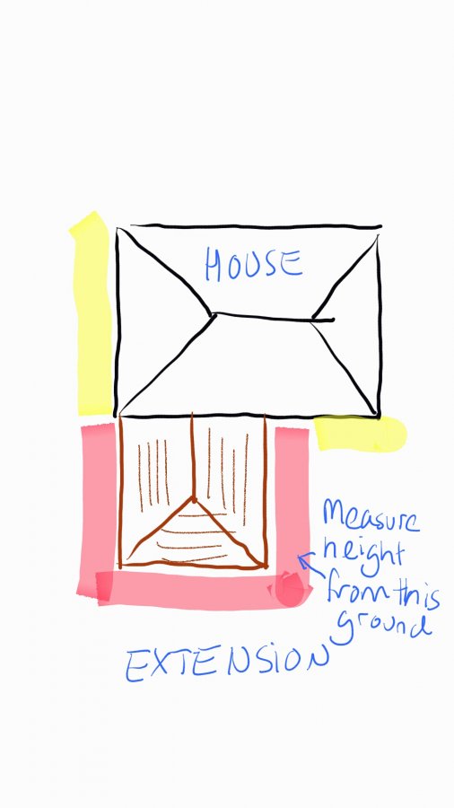

I have seen other posts regarding building an extension on sloping ground but would like further clarification as I am now in the same situation.
Basically I have spoken to the planners who are confusing and I would like to clarify this before I submit my drawings.
We are currently proposing to build a rear single storey extension. As we exit the kitchen at the rear of the property there are concrete steps across the fill width of the house which then lead to a lawn which is more or less flat. The level change from the kitchen door to the lawn is approx. 900mm.
Now when we build the rear extension the rear wall of the new extension will be more or less where the lawn is. So under PD the maximum eaves height can only be 3m and should be measured from the base of the outside wall. Now if we do this then we will be losing a lot of internal head room and our ceiling height will be approx. 1850 after accounting for the roof structure.
The PD technical guidance states the following:
Ground level is the surface of the ground immediately adjacent to the building in question. Where ground level is not uniform (e.g. if the ground is sloping), then the ground level is the highest part of the surface of the ground next to the building.
The above statement is OK when looking at the rear of the extension, i.e. near the existing kitchen. The overall height of the extension cannot exceed 4m. So when this is taken from the higher level we are OK in this aspect.
However the problem lies with the eaves whereby we would be measuring from the base of the rear wall of the new extension. Am I interpreting this correctly or I am measuring the eaves height incorrectly and will lose 900mm of internal headroom.
Can I take the base of my measurement for the eaves height from the highest level which is right outside the existing kitchen?
I want to avoid a step in the extension at all costs and also a sloping ceiling.
Please clarify if my interpretations are correct. Many thanks for your help.

If your extension has three sides, it's the ground immediately adjacent to the external wall on any one or all three of those sides.

Measure the height from anywhere in the red area - immediately adjacent to the new extension walls. Not the yellow areas.

Is any of the ground around the extension 900mm higher than the other ground?
If it is, I can't see what the problem is.

If you mean the ground around the extension as being outside the extension and as highlighted red in you sketch above then no.
Around the extension (the red zone) the ground is virtually flat.
It's difficult to say from your diagram. Height has to be measured from 'natural ground level'. If the floor of the house at the front is the usual 150-200mm above ground level there, it suggests that the natural ground level is sloping down left-to-right. If that's the case, the patio at the rear will probably have been built up. I suspect the natural ground level may be somewhere between the higher and lower dimensions you have been referring to.
It needs someone on site to give you a proper indication of where the natural ground level is.
