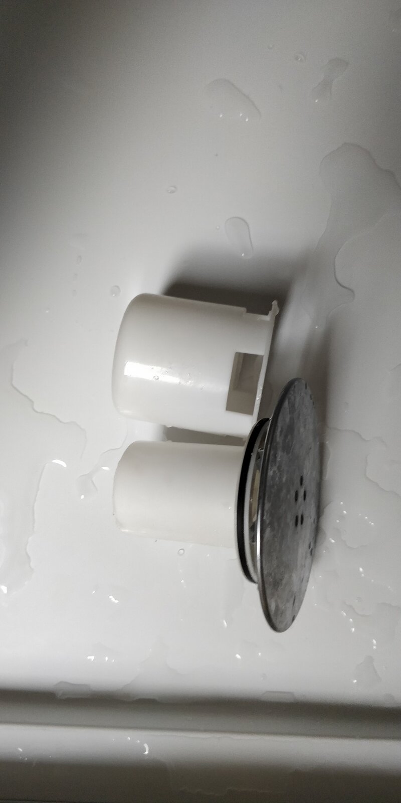

IMG_20200618_094934.jpg Hi all
Just installed a new shower!
Got the classic problem of a slow draining shower. I removed the trap from the waste (the cup part), and it drains fine.
Anyone else have this problem? Thinking if I make the holes in the trap bigger or saw a bit off the pipe that sticks into the trap water it might help.
See trap and pipe part below.
Did you install a new waste pipe when you replaced your shower?
Is this a more powerful shower then the old one?
The waste pipe is the same, and have poured a lot of chemical down it to ensure its not getting blocked.
The shower head is new, but I think the flow is more or less similar as it was before.

Surely if this was the case the drainage would still be slow if I remove the trap. The fact that if I remove it and it drains fine, to me it seems like an issue with the design of the trap.
Possibly but removing the trap can help the waste pipe breathe better therefore making it seem like there's no blockage

Remember there are miniumum water seals required on traps and cutting the pipe might make it too shallow

The pipe isn't fully blocked and filled with water, so I'm guessing if I plunge, it's just going to move the air over the muck that might be in the pipe and not dislodge it.

Chemicals may well do the same thing, and pass by whatever is blocking it. Mechanical means are your best bet, a Plumbers 'Snake' or similar. However, as you've used chemicals, be extremely careful, drain cleaner is basically acid and will burn through skin and tissue without a second thought.

Thanks. I have a snake but will have to go in via the shower tray. Is this advisable or might it damage the bends of the pipe from the waste?
