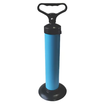

Try one of these with all other outlets blocked

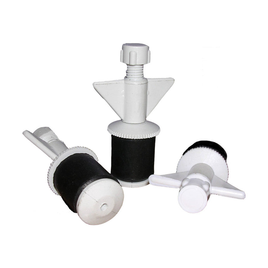

I guess there are but it depends on the type of overflow. If it's a basin's plain round overflow then a pipe plug could work or maybe even a bottle stopper
A bath overflow would probably be more complicated unless it's the ones that hold the plug, duct tape may work.
Okay you have me thinking now of a solution. Cheers Madrab
