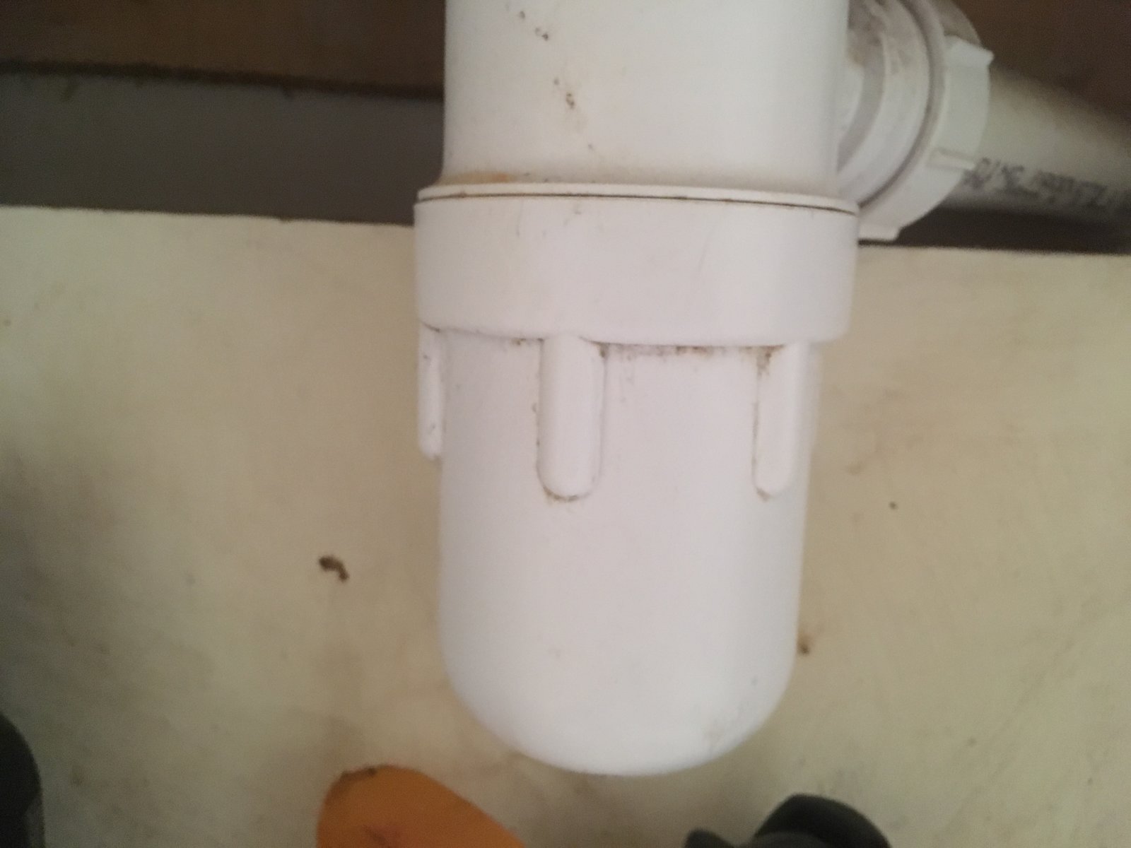

I have a slowly draining bathroom sink. Is the solution simply a case of unscrewing the plastic bit below the sink, and removing the gunk?
If I did unscrew the plastic part in the photo, how much water should U expect to come out?
Thanks.

Slip a poythene bag up over it having first loosened it,keep it upright after fully undoing and any leakage should be contained in the bag.... if water keeps flowing when its part undone theres a blockage in the pipes.

Hold the fitting to prevent any movement of the fitting where it contacts the sink, wear gloves and unscrew the bowl to release a little water and gunge. If water flows back from the right then there is a blockage further on.
There is an O ring in the bowl that shouldnt be left out or distorted.

Do not use chemicals, they are nasty, and can cause you more issues than they solve! Mechanical methods are always far superior for any blockages. If the sink is empty of water, then at most all you have is the contents of the trap, and whatever may be lying in the pipework downstream. Quite possible the bowl of the trap is full of gunk, if that is the case you may be better binning it and fitting a P trap in its place.
