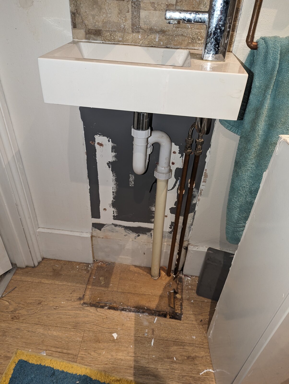

Hi guys,
We were wanting to give our tiny bathroom a bit of a make over. The first project is a new basin. The current basins depth is around 25cm and it's a vanity. I removed the vanity cupboard as we're keen on a wall hung basin to make the room seem larger
However the pipes are coming up from the floor..
Pedestal sinks tend to come out to far so that's a no go .
Leaves me with three options..
1. The easiest.. have the pipes exposed and paint them..
2. Medium difficulty. Box them in..
3. Hardest.. reroute them behind the wall .
Not sure what's going to look best, any thoughts..
Aldo, ho difficult would the 3rd option be, I'm pretty good at DIY, but never attempted something like this..
Floor is being replaced eventually do don't mind opening this up..
Thought you might say that.. .. So anything I need to know before attempting it..
Basically, anyone fancy giving me step by step instructions ..
I recently put pipework into a wall to allow a basin to be fitted in a cloakroom , DIYer
however i took the floor out to see where/how the existing pipework , went to see if i could re-route - particularly the basin waste with minimal bends
can you lift the floor and see what your options are
