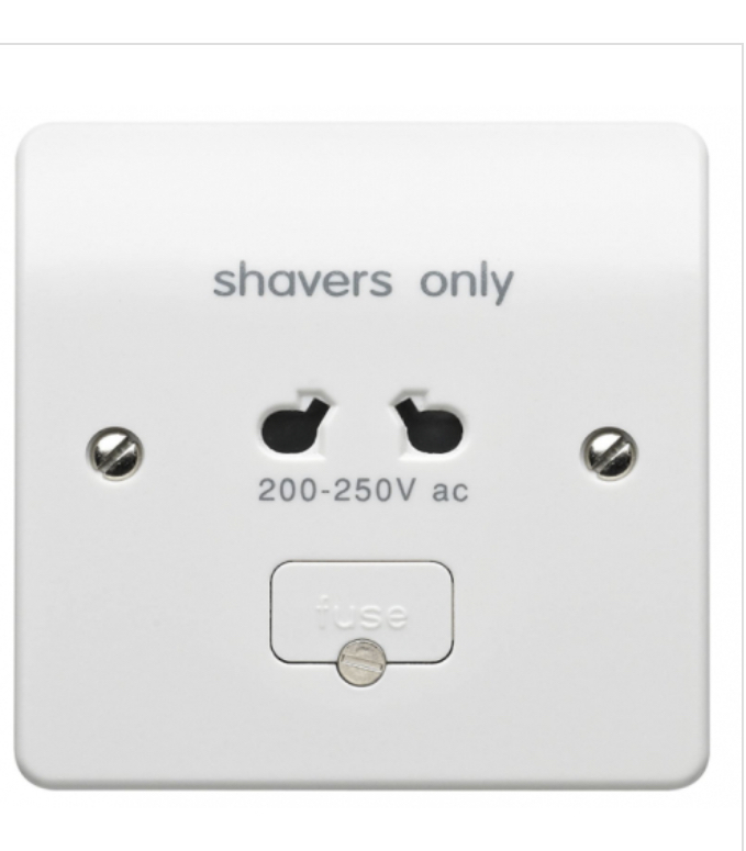

You need to be careful as a compliant and safe shaver socket includes an isolating transformer. That is why they are so large.
Sockets like this are NOT permitted in UK bathrooms.
