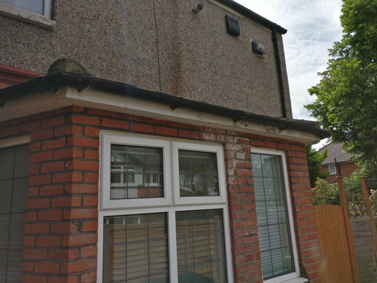

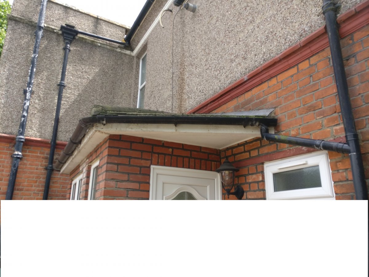

We have a small pitched roof to provide access to downstairs flat converted in an Edwardian building, which we moved into few months back. I've attached some photos for easy reference of the problem. Bit of description in order marked in pictures

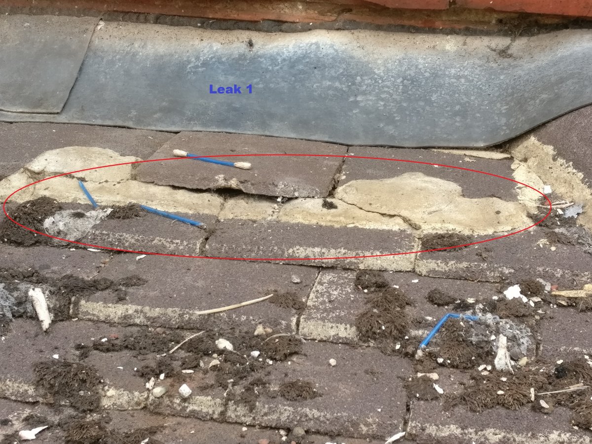

Leak area 1. Both roofers said, there is like a missing line of tiles which should have really been there Some repair with mortar seem evident which indicates attempt to rectify the problem previously.

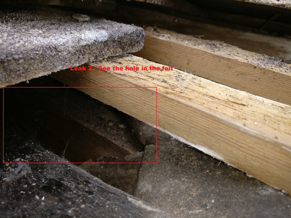

Leak area 2. Roofer B lifted the tiles just above the gutter run under which the leak near window comes in and I could clearly see 2 big holes /sagged felt. Says it happened because the main leak at point 1 above is root cause of problem, which lets the water under the tiles go in which then dribbles over the felt to the lower section and leaks in the holes/sagged section of felt near the leaky window. Some damage to the timber battons near window and fascia board was also evident as you can see. Roofer A only suspected that to be the case though said chances are high that's happening, so will see when he does the work for problem around window and replace path of felt if that's what it is.

Please let me know if you need more pictures. I can't understand how water sinks in via that section but that's where we can see some attempt of repair etc.

From what I can see you have plain tiles on that porch which
need at least a 30° pitch. I suggest if you are going to spend
any money then use a tile more suited to the pitch you have.
It needs to come off. As you can see its been an issue for some time. Judging by the brickwork staining and soffit/fascia staining.. Though that might be gutter over spill
It also looks like a gutter leak from above maybe running down the wall? or an over flow?
The hole in the felt is probably because its rotted from all the water on it for years..

Umm..there is a stopper end on the gutter above but it seems to be right above where the potential problem is. What can I do to check if that could be the cause. To be honest I now understand that how would water be coming from top of the window but don't understand how it goes in where roofers said it seem to. Though there is some repair done to it in past with mortar on that section, but doesn't clear show sign how water would ingress from there.
Well ill go along with its not 30 degrees pitch, minmum really is infact 35..
That aside, There appears to be various pipes and wires hanging out of the wall are these seal to the wall?
I still say it needs stripping and doing properly..
