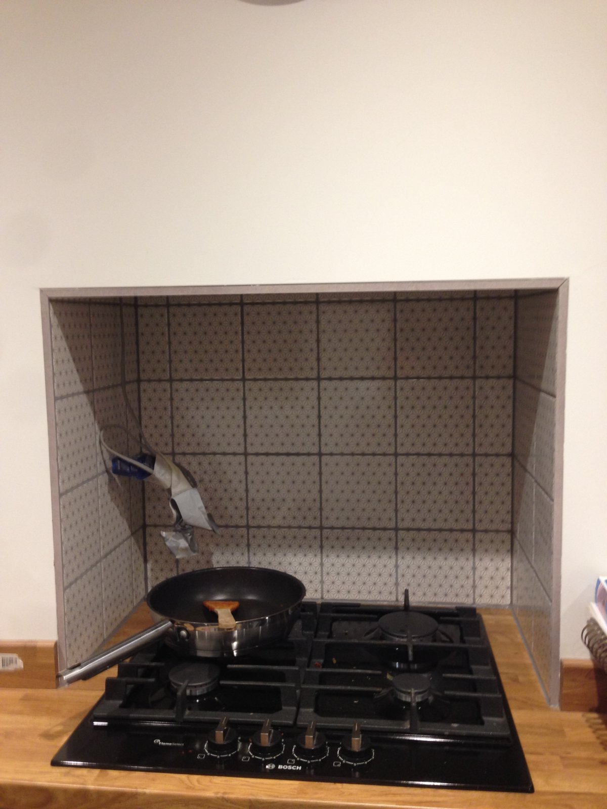

Evening,
I opened a fireplace in my Victorian semi, raised the lintel and put in a cooker and hob.
Surprisingly I'm having trouble finding an extractor to fit into the hole.
Dims are about 230 x 500 mm.
The extractor ducting and electrics are in place.
Cheers.

It would help wouldn't it! I've added a few pics.
The ducting is 5''.

a canopy extractor will work and you can easily find one with a 5" dia.
depends on how far you are extracting to a terminal but its good to get a powerful motor - as silent as possible.
i think the lintel was set a little too low but unless you use flaming Woks it should be OK.

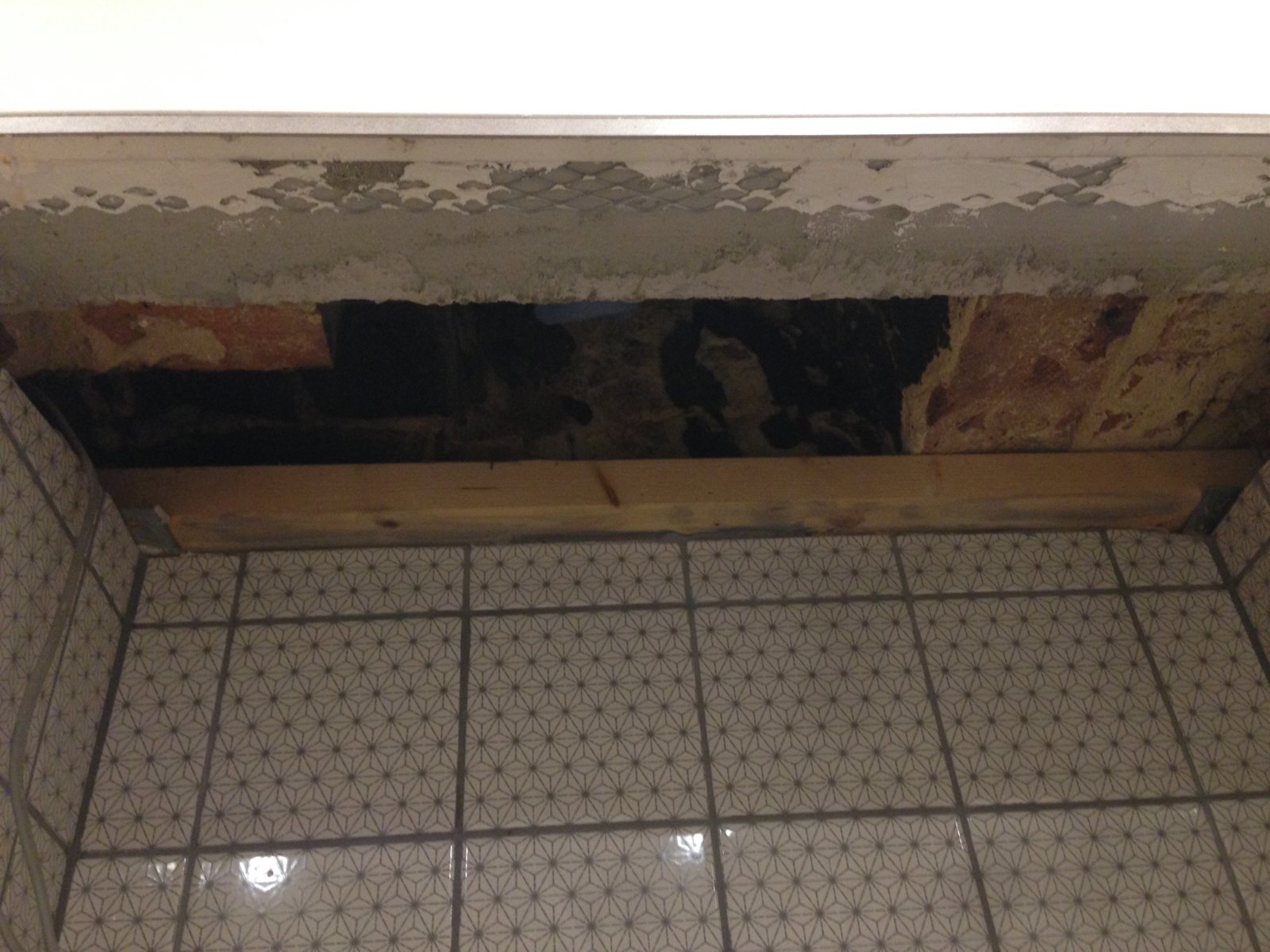

has that flue been swept? if not you have to have it swept.
i dont see any ducting?
can you show the ducting?
if you ever do this again use angle iron not timber.
I've really struggled to find one that would fit.
The distance from hob is perhaps 5cm short max so ok. Bosch came out for a hob warranty issue and said it was ok.
The timber is a temp fix for a bit of ply that stopped muck coming down.
The chimney has been swept.
you could fit something like this
https://www.tlc-direct.co.uk/Main_Index/Ventilation_Index/4_Inch_Fans_Kit/index.html#Kitchen_Fans
but it would have to go up in the chimney void or it will be too close to the hob.
there is a smaller one but it does not seem to have a grease filter, which you need or the duct will get coated with flammable grease which will drip down into your fan and food. This one you can remove the fan and filter to clean. Might be worth keeping a spare set handy.
Or like this, fitted up your void (600mm but other sizes available)
https://www.tlc-direct.co.uk/Products/ELERAHESS60.html
Professional kitchens use steel shutters that close when you have a hob fire to prevent flames setting the duct alight.
You can fit a fan in the chimney and make up a steel plate with cut out to accept grease filters but venting into open chimney will result in condensation running down along with grease build up which could result in a fire.
The distance to hob varies by manufacturer and hob type, the smallest distance I have seen specified was 660mm while the largest was 800mm.So taking one manufacturers guidance could lead to problems .

you wouuld need a partition or boxing to separate the chinney from the room. The fan would need to be on the room side with the duct passing through the partition. I'd prefer a non-flammable damp-proof material such as hardiebacker, but there might be a better way.
if you had raised the lintel a few courses higher you would have been able to install a conventional hood extractor, & gained the typical Mfr's dimension between the hob and the appliance.
with what you've got, presuming you are ducting sideways out through the c/breast cheek, you will need as i suggested above - a canopy extractor.
above the canopy extractor you can fit a metal plate or a backer board plate to totally block off the flue - you would then ventilate the upper flue with a vent through any convenient side of the chimney breast.
fwiw: for a swept flue it sure looks sooty, which is not good.
This is going to be a proper mission! Quite tight up the chimney.
Was hoping to slot in a canopy unit with light etc.
PS. The flue was swept, but yes its grotty and some muck does come down during high winds..... Not much, just a few chunks.
