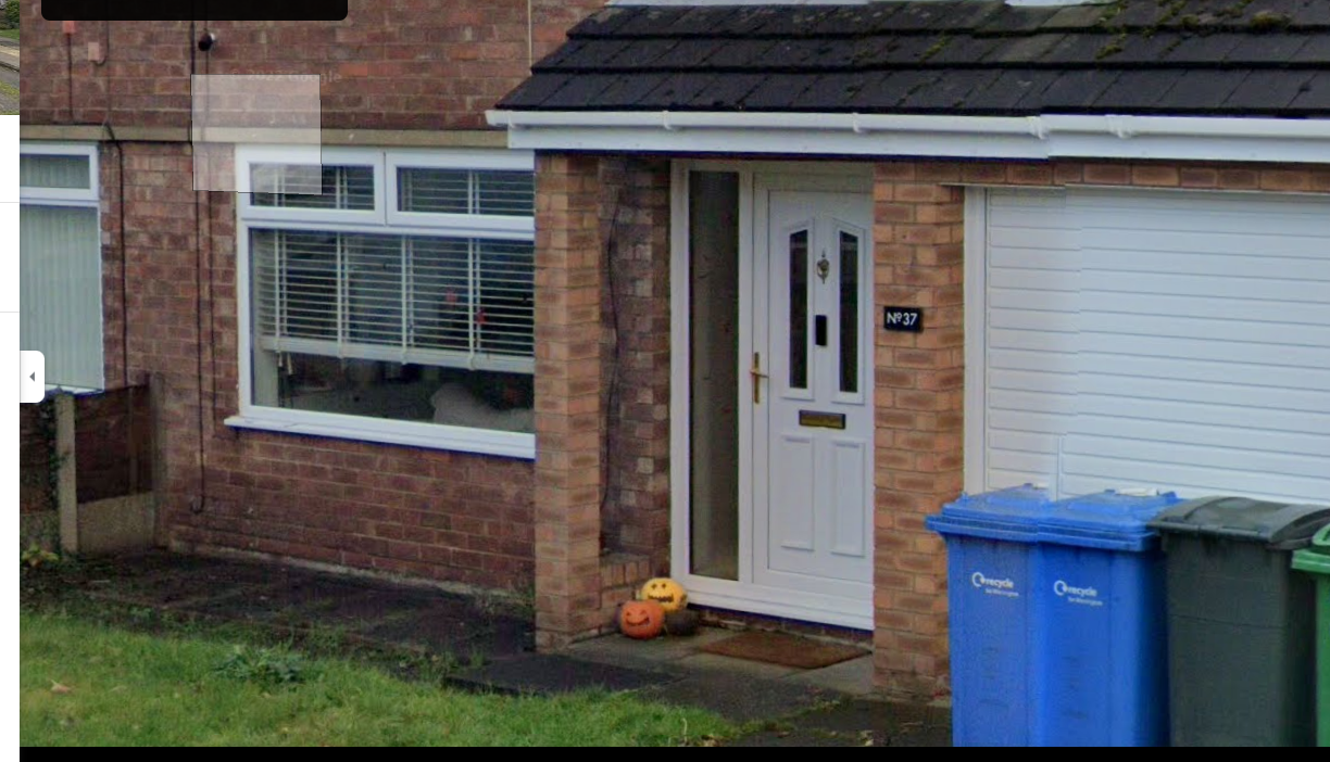

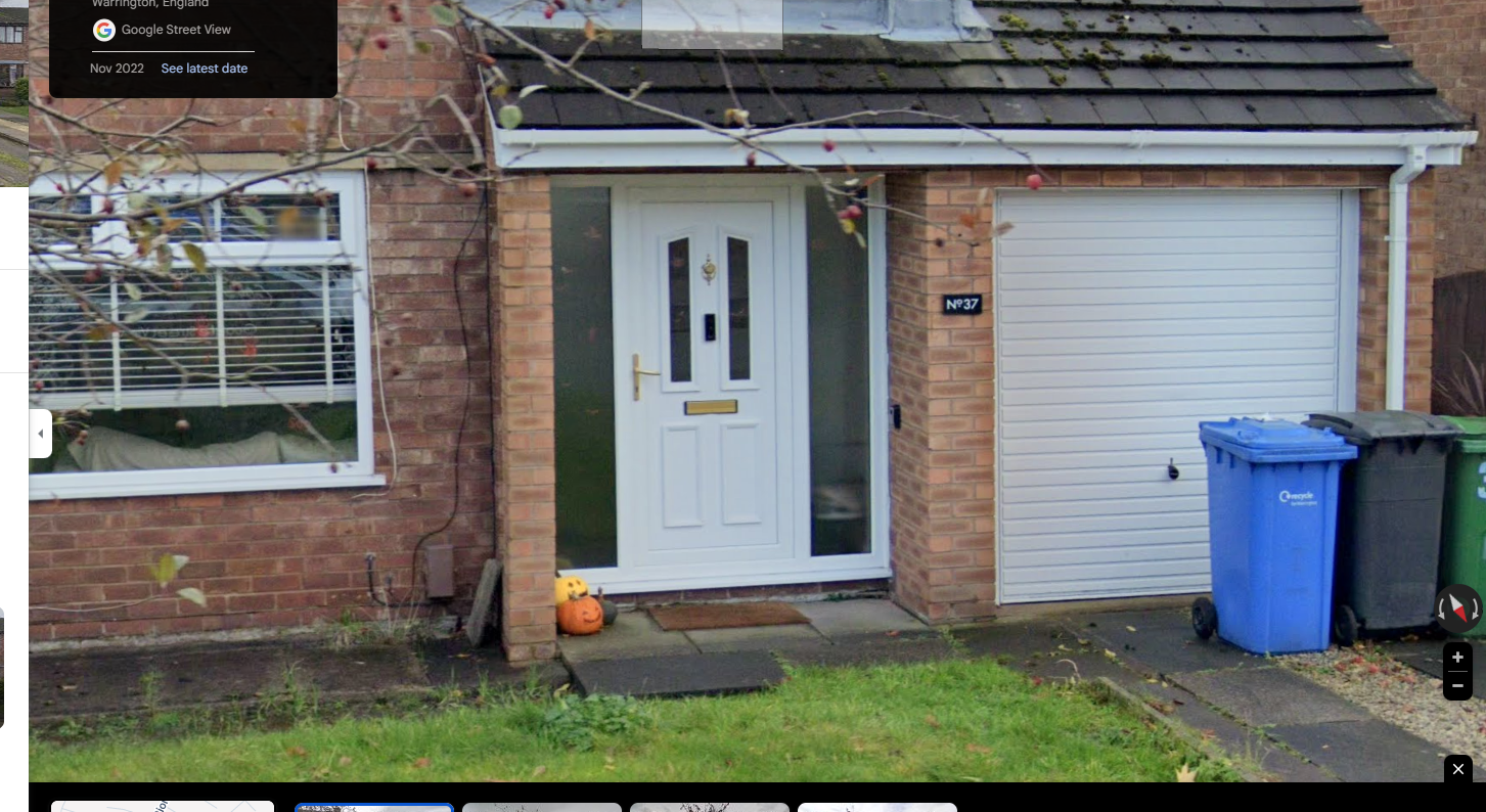

Advice needed for building a small porch at the front of my house potentially...read mulptiple threads and cant really figure out if I need PP & whether i need to dig full foundations for this with it being so small & already having some existing brickwork.
Existing front door is set back under shelter from the roof that comes from the garage - if i was to simply have a similar door/glass panels in line with the front garage wall & have some sort of internal door inside to separate the hallway & porch area
Would i perhaps just need a small foundation at the front where the new door would be to build up to DPC? then concrete slab for the floor inside?
As for the small side near the bay window, im open to whatevers easiest rebuilding as a full wall or building up for a window.
The garage isnt original but could there be existing foundation there already given the brick column that is there at present?
