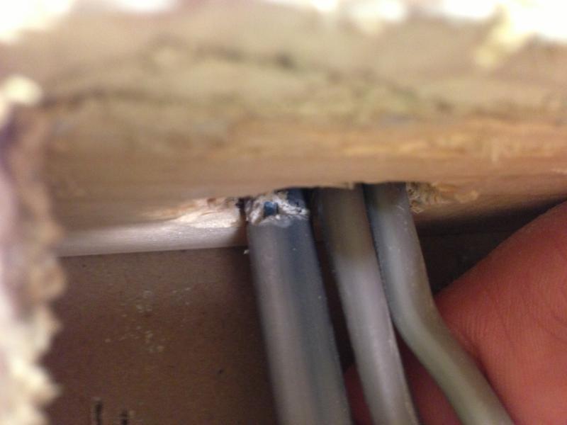

Over the weekend I was moving a telephone socket, while I doing this I noticed a small spilt in the outer sheath of a nearby the twin and earth cable around the area where the cable was pulled though the timber (in a stud wall), I can see the blue neutral cable within the twin and core, the blue sheath appears not to be damaged. Is this something that I should be considered about, is this against the regs?.

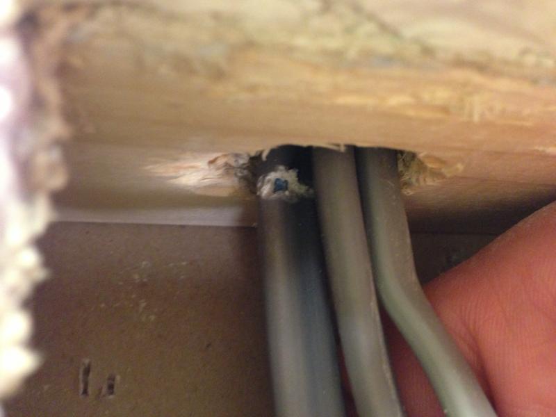

I have uploaded the best image that I could get to: ... Getting a little worried now.
That does look a lot worse than I envisoned when you referred to a 'small split'. The problem is that one really can't tell exactly what is going on within that cable. Even if it tested OK (which doesn't necessarily prove a lot), I must say that I would be very reluctant to just 'cover that up'.

Thats is a little tricky, as there is no more slack in the cable to get a better look.
Have a look and if none of the conductors is damaged just do as Eric suggested.
If that could be done, I agree - but I fear that it might not be easy to get a good look at the conductors. As always, without being there, one can but guess.

I have only just noticed the picture and agree it is worse than described.

If not, carefully cut out a short section, say two inches, of the insulation to inspect the conductors and if they are in an undamaged state then cut a two inch length of insulation from another piece of cable, split it lengthways and put it in place of the missing insulation and thoroughly wrap in self-amalgamating tape.

I think some little furry-tailed mammal has been having a chew. Is there any sign of loose insulation debris below the defect.
It does look a bit like that. A more dramatic example, which I initially posted a while ago, is:
The teeth marks look quite similar to the appearance of the OP's cable! The above photo also illustrates the point I made in this thread about testing "not necessarily proving much". For reasons which are fairly obvious, that cable tested as 'fine', but it clearly represents a serious hazard!
