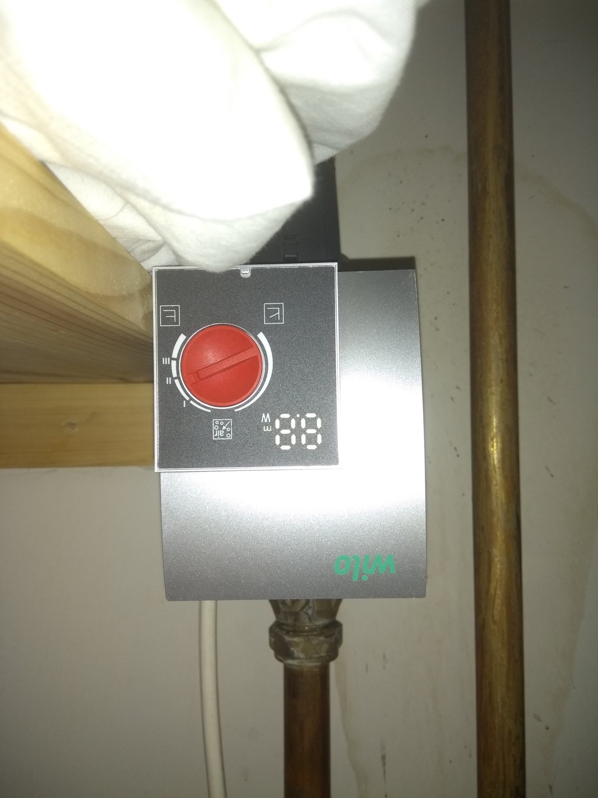

Hi all, looking for some help. Should the small tank in the loft be hot? I'm at the in-laws and there is a right old noise going on from the hot water cylinder. Popped in the loft and can see steam coming from the smaller of the two tanks, it's boiling hot. Any ideas?

1. The smaller of the two tanks is likely to be the feed and expansion tank for the central heating system. It should not have anything to do with the domestic hot water (DHW) system.
2. It should not be hot. Might be slightly warm accommodating expansion of the CH water.
3. A number of possible causes:
3a. Blocked feed pipe from F&E to boiler.
3b. Pump turned up too high.
3c. Thermostat problem with boiler.
It can be dangerous, as plastic tanks are not designed to take high temperatures for very long.
Get someone in. In the mean time, maybe turn the heating on and then off as soon as the overheating starts, assuming you can't live without heating.
NO It should NOT be hot.
Run hot taps tp get cold water into the cylinder to cool it, Beware the water will be scalding hot. Put cold water into the basin / sink to prevent the basin over heating.
As mentioned check the imnersion is switched OFF. It would appear that the thermostat in the immmersion heater is faulty and is not turning the heater off.
Do theyhave a back boiler that heats the water, if they do then reduce the fire
Great thanks for the replies. The immersion is switched off. A new pump was fitted a few months ago, see picture. Not sure where the red dial should be, I haven't touched it. They have an old potterton boiler in the kitchen.

Hard to tell when the problem started as today was first time anyone has been in loft. The pump was fitted in may I think, mother in law says it has been noisy since! ( Only just mentioned that!). She did speak to fitter but he claimed old holier and kettleing. When I looked at the hot water cylinder it sounds like it's going to explode!

Does it matter that the pump seems to be upside down? See pic earlier in thread.
If you look more closely, you will (should) see a vent pipe, in an upside down "U" shape, over the tank, so it can flow water into it. Is water coming out of this pipe?

Vent pipe may be below the level of the water in the F & E tank and the water circulating bu syphonic (?) action.
