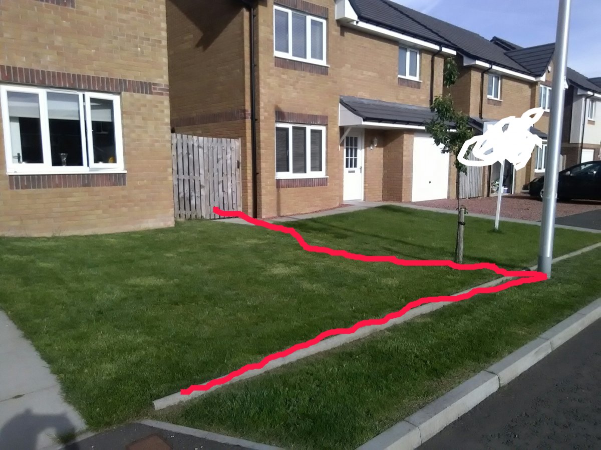

I'm looking for advice on building a small wall in the garden. the garden is almost level. its to separate the two front gardens if you get me.
the wall will be 12m long and has 1 90 degree turn. double skinned and a slab type coping and 4 bricks high.

That's the garden there. Not the best of lines, but it would go round the tree and replace that grey kerb.
Have you considered a fence or small trees? Also given the age of the house, have you checked covenants not to do what you are planning. You have a challenge with the footings around the lamp post
