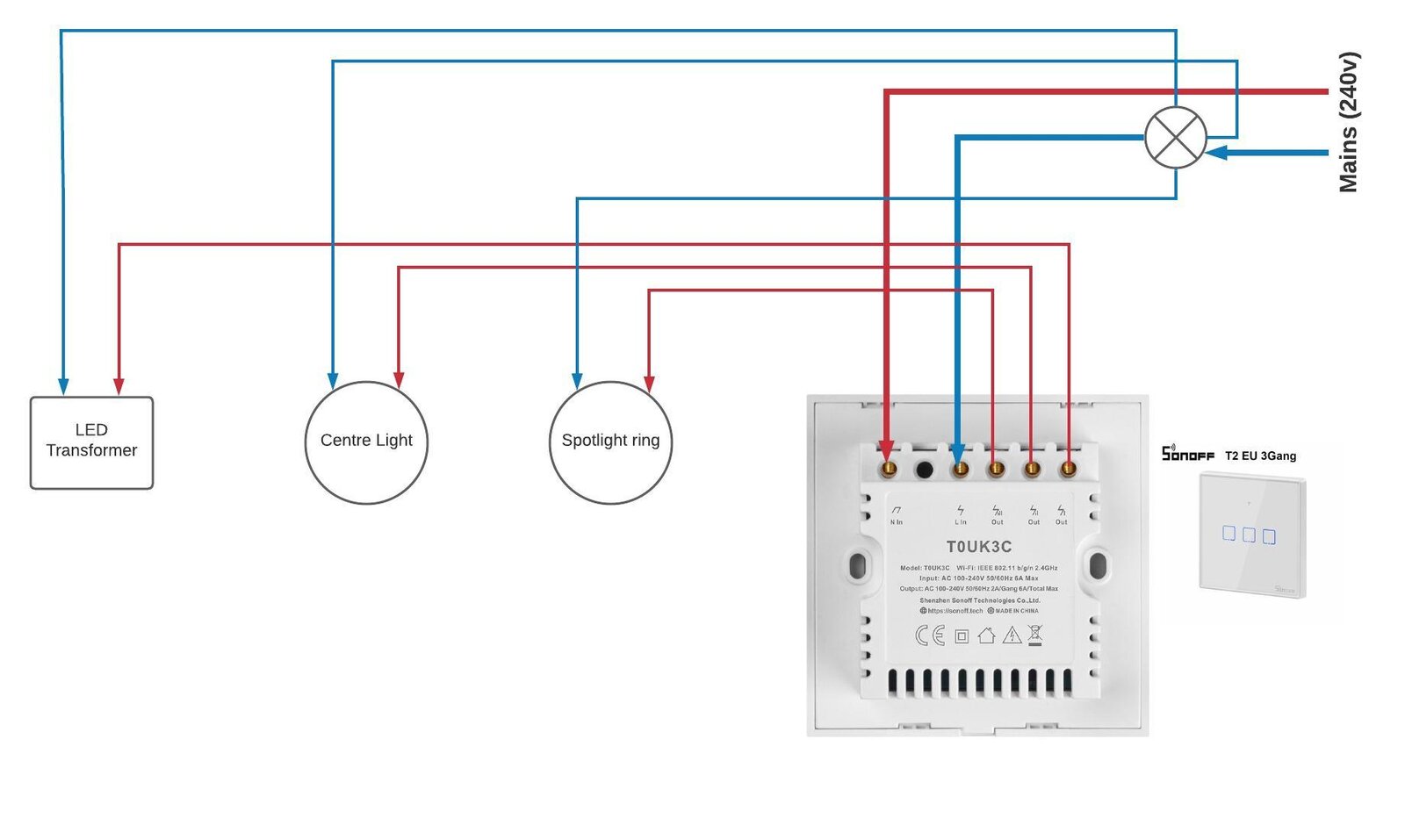

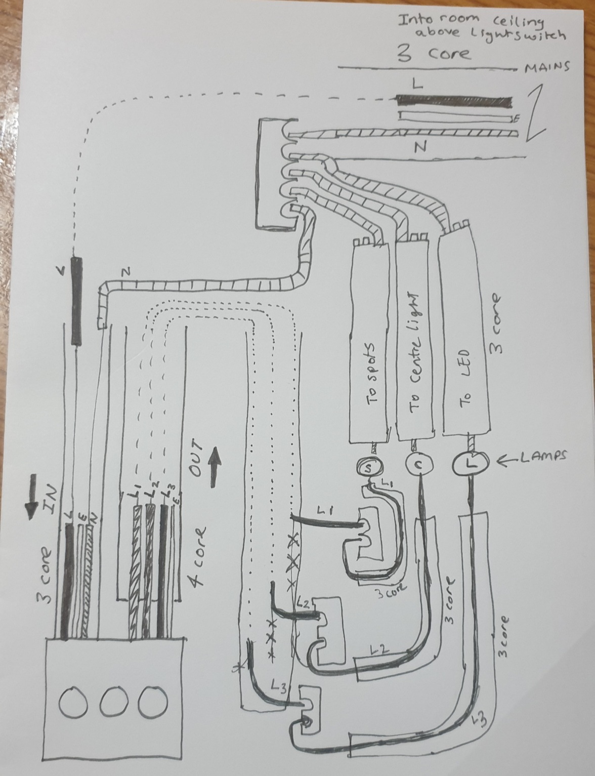

Lighting diagram attached. Go easy. I'm not a qualified electrician but am an uber geek when it comes to general electronics and I work in IT (obviously).
Due to start a strip/rebuild project soon and will be installing wall mounted smart switches for all the lights in the house. Yes, there are no-neutral smart light switches available (though not by this manufacturer) and there are a gazillion ways to controll lights but this particular way satisfies a whole bunch of other needs with regards to my choice of home automation. I.e. there's a bigger reason behind using this exact switch.
My standard design for each room is to have a spot light ring, centre light and LED lights (inside coving). LED lighting needs some additional planning but enough to say that I want to install the wiring for the transformers now. Each room's lighting will come of a separate breaker.
If you're an old-hat sparky, some background....smart light switches need to be powered up as if they are small computers (i.e with a Live and Neutral). From the switch are L1, L2, L3 (outputs). The wiring is obviously not simple when compared to a good old fashion switched Live circuit, so I've been busy working out what the best way is of doing this. Please see my diagram and offer me your views on legality/safety plus any tips, warnings, suggestions for type of wiring, connectors, junction boxes. Given there's potentially 4 x 3 core sleeves going into the backbox, I'm looking for a smarter solution. Remember, this is a new build, I can put whatever I like behind the walls or in the ceiling.

First observation is your error in where you are putting the Live and Neutral to the switch
Make sure that you can operate some lights when the Home Automation system shuts down or becomes erratic in operation.
Lighting and your diagram are not 'ring' circuits.
'Ring' is not another word for 'circuit'.
EFL is right to show the Neutrals to lamps running next to the Lives to the lamps. This will significantly reduce radiated EMI ( 50 Hz ) from the lighting cables.
EFL, though this has the advantage stated by bernardgreen (which id like to find out more about), that's an incredible amount of wiring in the backbox. I would like to avoid jam packing thr back box in favour of junctions boxes in the ceiling. Thoughts?
It really isn't. Four cables, twelve wires aren't that many.
Although, obviously if you only have a 16mm. back box, you probably won't even get your switch in.
Junction boxes must remain accessible if they have screw terminals.
Maintenance-free JBs may be hidden but you won't really want that with what you are doing.
I have used a 'wiring centre' in a loft but that entails running all the cables to it - as in normal switch drops; not just half of each circuit. You won't be using singles in conduit, so likely and you will still have as many cables to the switch.
Thank you Bernard, It's very gratifying to see others now saying the same thing I was being criticised for a few years ago.
