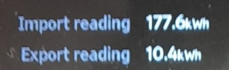

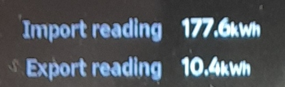

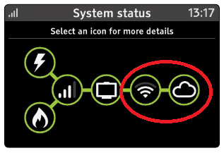

I am also considering a duel tariff, it would suit me to charge batteries over night, but I see no trigger point on the smart meter that I can use to tell the inverter when to charge batteries, I had expected to be able to view my usage on the PC. However it seems this is down to the remote monitor, some have a wifi functions others don't and the supplier gives no instructions, one has to hunt the internet to find instructions.
Only then did I find how to get to this page 1708254249719.png and find the items ringed did not exist. OK for me no big problem, I can see what I am using through the solar panel software, it took me an age to find 1708255191856.png which is really the important bit of the meter. It also gives an MPAN number and it seems I have given the wrong one when applying for payment for export.
In other words it is not made easy, seems I will need to phone British Gas tomorrow and rectify the error. I know were I use to work, the offices had storage radiators and there was a massive contactor to deliver power off peak. But this was in turn powered by a simple time clock, I have scrolled through the internet to find out what it required to switch items on during the off peak times, and sorry to say can find very little.
