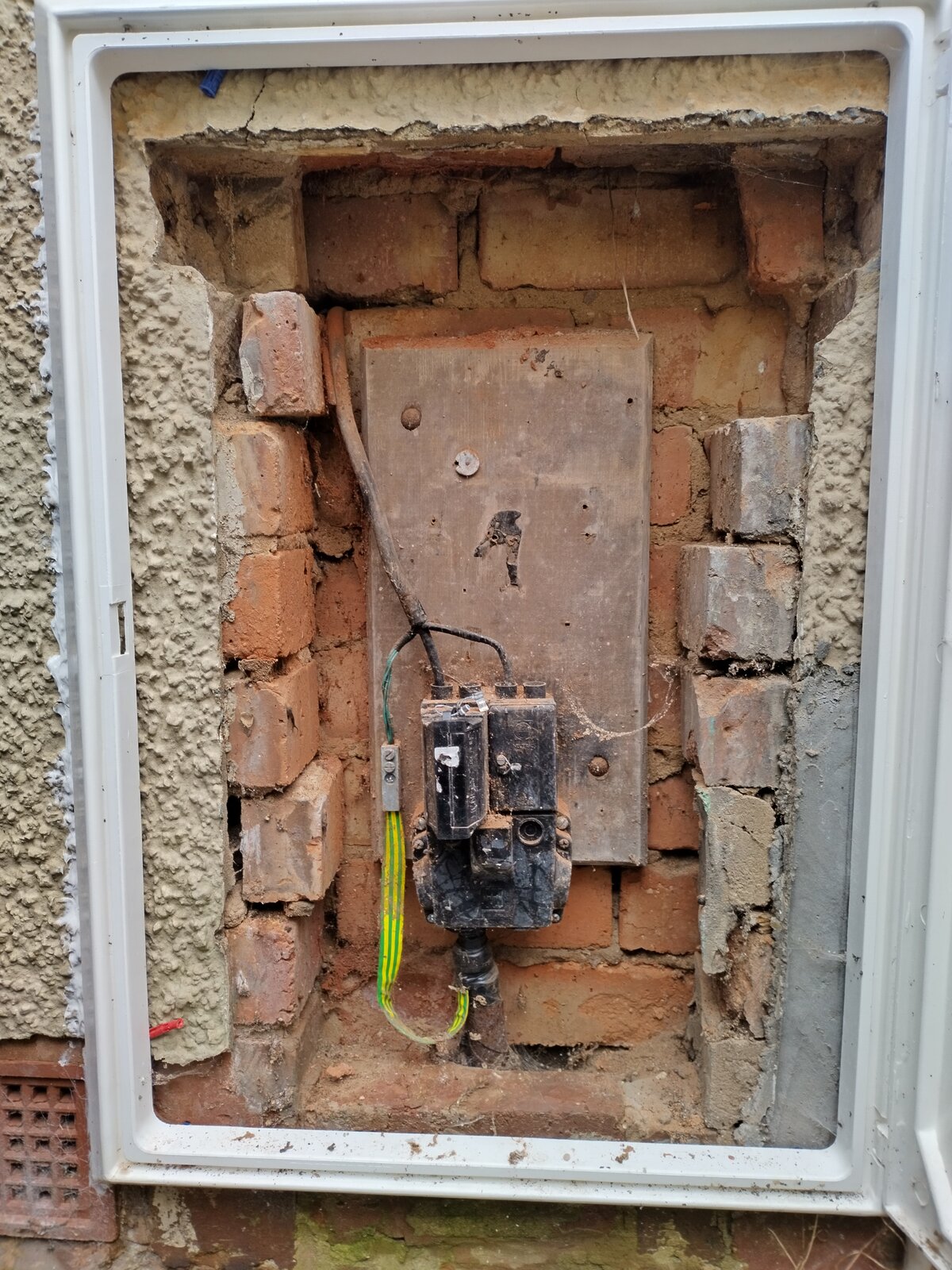

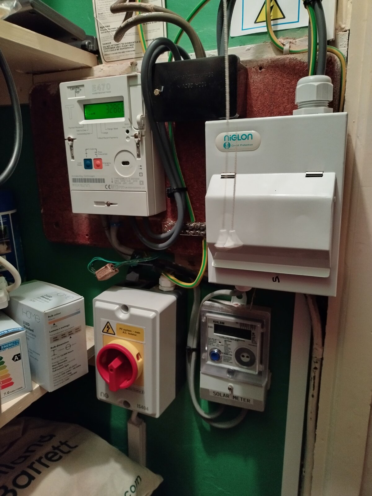

Can anyone help me understand why this work would be necessary?
A smart meter engineer visited my property in August to replace my current Smart Meters. He looked at the outside cupboard where the cut out is and said he couldn't fit new smart meter due to "the way the power comes into the property". He said I would have to pay an electrician to "rewire from consumer unit as the meter would need to be moved outside by the cut out". (Meters are currently in cupboard on other side of the wall). He said he had seen quite a lot of these and would update my records so that BG wouldn't keep hassling me to upgrade and I thought that was the end of it.
However, this week the smart meter on my gas has developed a fault and keeps switching itself off and closing the valve. BG have told me I need to have the electrical work done to upgrade for this to be resolved.
I had an electrician round to quote for the work (£365 !) to "install meter tails from the external meter cupboard to the Henley blocks by the main fuse board" but, when I asked him why it might be necessary he said he wasn't sure and that maybe it was because outside signal was better or that their T&Cs said to have it outside. He said the work would leave me with no power until BG come to install the smart meter. BG say they will try to co-ordinate so it can be done on the same day.
I have scoured the internet but haven't found anyone else who has been told they need to have this type of work done. I would really appreciate any advice/information.

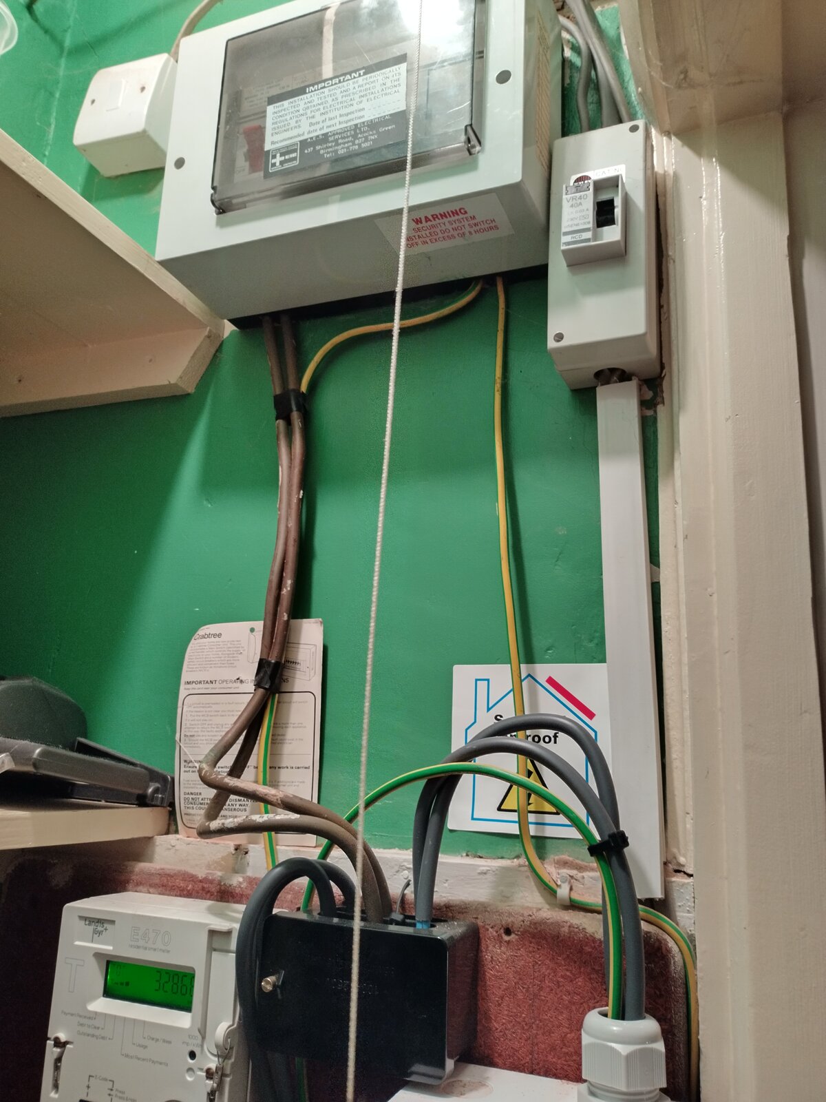

Several problems:
1 - The cutout should be located next to the meter, so it can be safely isolated while the meter is replaced.
Having the cutout outside and the meter inside does not allow that, so it's either move the meter outside or fit a second red link cutout inside next to the meter.
2 - Cable from the cutout is not the correct type, looks like a piece of grotty old T&E that someone has hacked about. Replacement required.
3 - That 'meter cabinet' isn't one, it's just a modern GRP door shoved over the hole where some previous and much older cabinet / door would have been.
The best solution would be to install a new meter cabinet (recessed or surface) next to the existing cutout, have the network operator relocate the supply into it with a new cutout, have the energy supplier install the meter into the cabinet with the new cutout, and then have your electrician install cables from that to the consumer unit inside.
The hole in the wall where the old one is would need to be reinstated afterwards.
Unfortunately that will incur a non-trivial set of costs and will require that the DNO, supplier and electrician are all there on the same day.
Another cheaper and quicker option would be for someone to fix a second cutout to the wall inside, connect tails to it and run them through the wall to the existing cutout leaving the ends outside unconnected.
You might be able to convince the energy supplier to connect those to the cutout, and then connect their meter inside to the second cutout.
grotty old T&E??
I've never seen round T&E in this country.
Very obvious to me that is split con used in a very normal/standard way by DNO.
As has been stated already not the responsibility of the customer and certainly not up to anyone but DNO/supplier to say it needs replacing.
