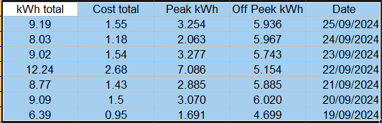

If I look at the rates, single rate 24/7 was 29.57p per KWh and 62.21p standing charge, with split rate 8.95p per kWh off peak (5 hours), and 31.31p peak with a 59.14p standing charge. So if I used 554 watt (yesterdays use divided by 24) through the day, then £4.55 single rate and £4.14 with split rate. Since at least 2.88 kWh will be over night (charging batteries) and I can set dish washer, washing machine and tumble drier to run at night, the gains will be more than that. Then add the solar production and even more again as hardly use any peak power, so with the minimum of effort, I can save a lot of money, I did a excel sheet to look at if worth a second battery and over a week
got the following, nearly every day I am using more off peak to peak power. Centre day was odd one out.

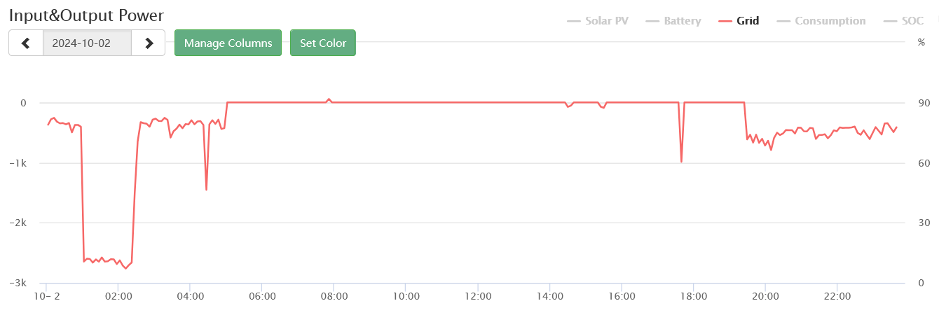

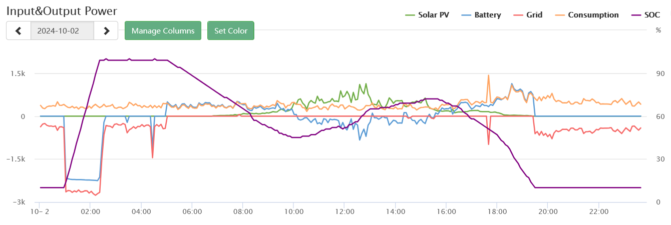

Today the power used 1727908877836.png and I would say we should be able to read this with a smart meter from our PC or phone, but that is not available. The full days graph 1727909038728.png shows even more info, and the software also shows totals imported 7.4 kWh and consumed 9.9 kWh solar produced 3.7 kWh and 4.3 kWh went in and out of battery to smooth out the peaks and troughs, did not get enough solar today to export anything.
