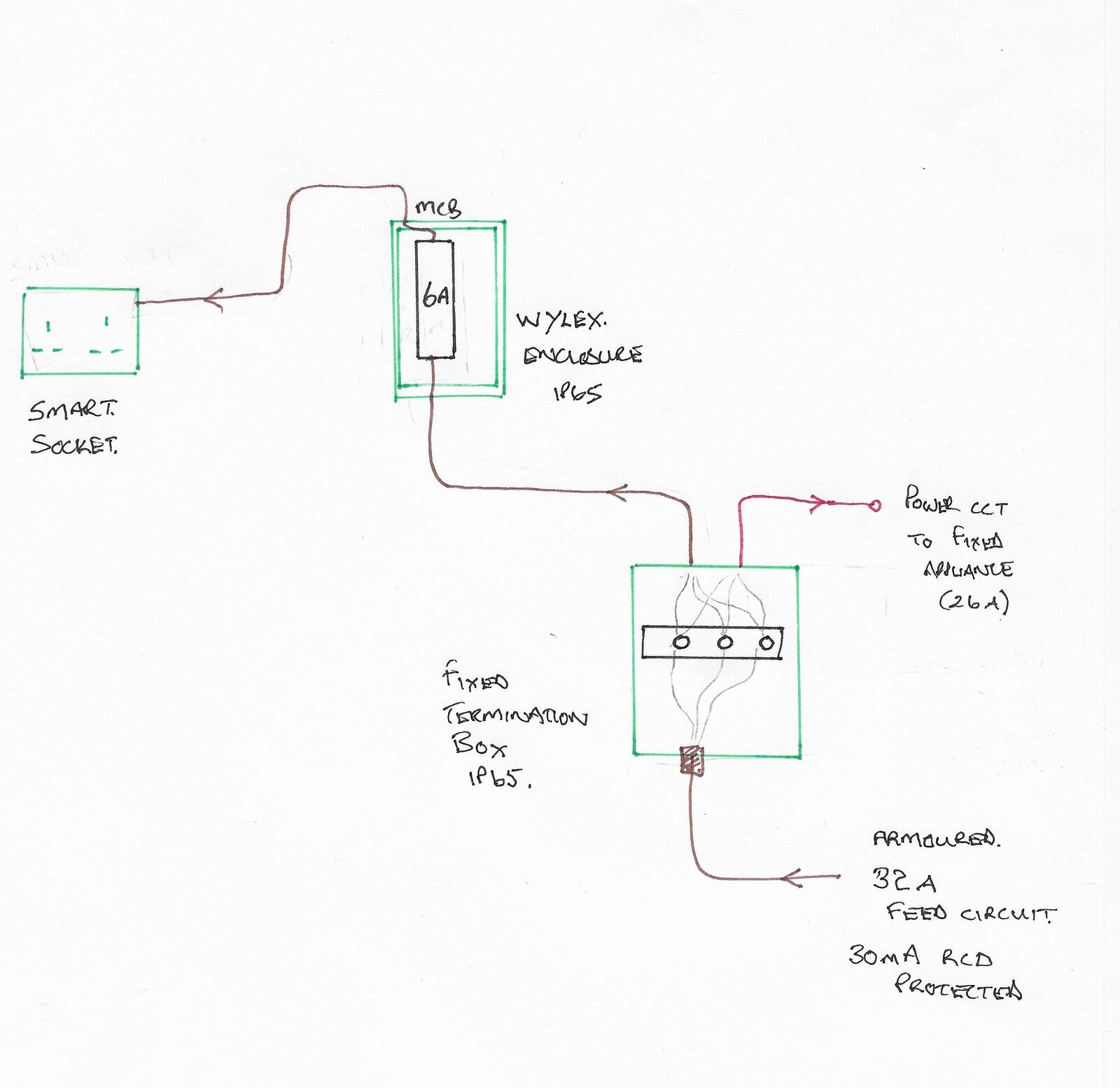

Related Q .... this will get its supply from a Wylex enclosure;
Is it OK to run the cable direct to a 6A MCB, providing a dedicated radial cct for this socket, rather than run MCB to a fused spur unit, and then connect new socket to that.
Current limit provided by MCB safety is covered, and is simpler.
The supply to the Wylex enclosure comes from 30mA RCD protected 32A radial circuit.
Yes, there is no point having an Fused Connector Unit on a 6A circuit.
Ok.
You are allowed one (double) socket on a spur(the cable) without the MCB because the plug fuses will do the same job.
That is if the spur cable is 2.5mm² and can handle the current allowed by 2 x 13A plug fuses.
If you want to use smaller cable then the 6A MCB will be the way to go.
Smart socket is 13A ... I only need it to handle <2A, as the 2 LED strings combined are 40W, even allowing for some conversion loss, still very low current draw.
Hence I thought MCB at 6A is more than adequate .... the strings themselves will be dasiy chained to a single 3A fused plug.
Using MCB option limits current, and avoids the need for Fused Spur box.
Reason for the WYLEX enclosure is the capacity for a 2nd MCB if I needed to add another light in the future, I'll use 2.5mm t&e to the box.
A picture is supposed to be worth a 1000 words so the attached may help

Well, yes, it does but what is the difference?
Ok. If you want two switches, As you said 6A is plenty for many lights.
Ok.
That would then be 2 spurs off a spur which is not allowed.
That is not true.
With 2.5mm² cable: if they are limited to 13A by an FCU (it being 13A merely because that is the maximum rating of fuse that will fit in an FCU - 25A would do if there were one).
Do you not think two 6A MCBs (or indeed two 13A MCBs) would have the same effect?
