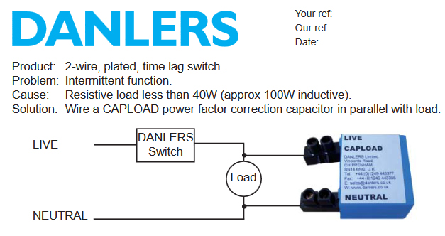

Started with 1 some 4 - 5 years ago and it worked well, used as no two way switching in bedrooms, expanded to 5 around 2 - 3 years ago, and found problems used with some LED bulbs, the E27, BA22d, and E14 all seemed OK, but the G9 caused a lot of problems, and had to swap GU10 until found 3 that worked OK.
The G9 flashed when off cured by using a load capacitor load-capacitor.jpg but also a shimmer when on, swapping one bulb to a tungsten stopped shimmer, but in the end did find a bulb that worked, G9-comp.jpg the smaller bulb had shimmer, had one of the larger ones fail, so opened to have a look, found fault, but also could see why no shimmer, there was a smoothing capacitor inside the bulb nearly as big as the whole of the smaller bulb.
