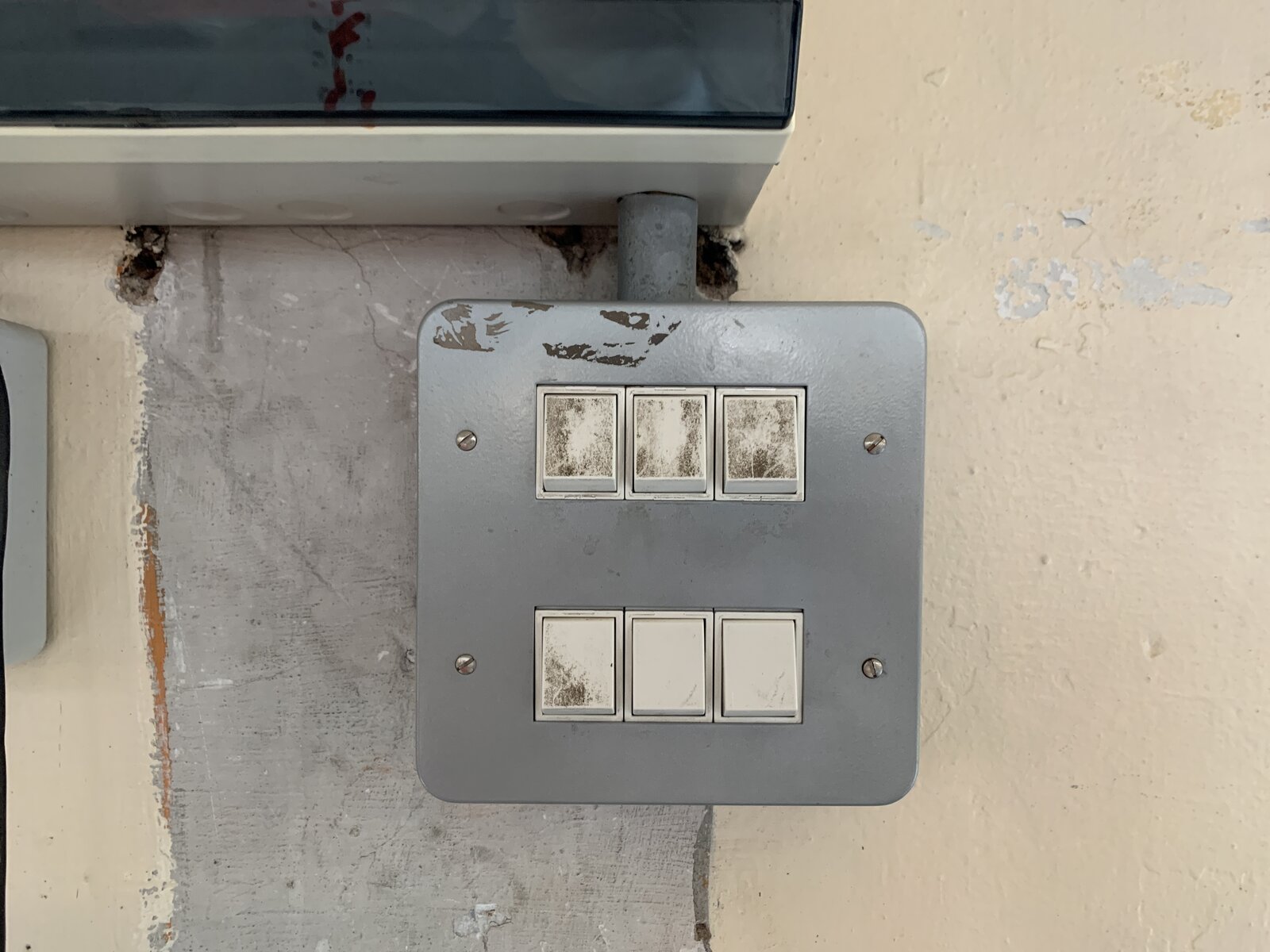

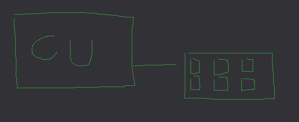

I have 6 switches in a grid all of them right next to a consumer unit in our factory that control all the lights in that floor. They are all single switches that each controls one zone in that floor.
I want to swap these with single smart switches that require a neutral.
Can I run one neutral wire from the CU to the first switch and then connect from that switch to the next and so forth or do I have to run individual neutral wires to each neutral terminal on the switches from the CU?
Assuming these are regular lights and within the amp limits of the circuit, you can daisy chain the N. There is a risk that a fault will impact any down the chain. So running them into a choc block and then out to each unit might be easier.
