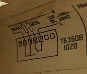

Hi,
Im looking to purchase a smart programmable thermostat to replace an old Honeywell T6360B, which as you can see from the pics no longer has any print left for temperature setting (was like that when we moved in!) and is pretty hit and miss clicking on and off!

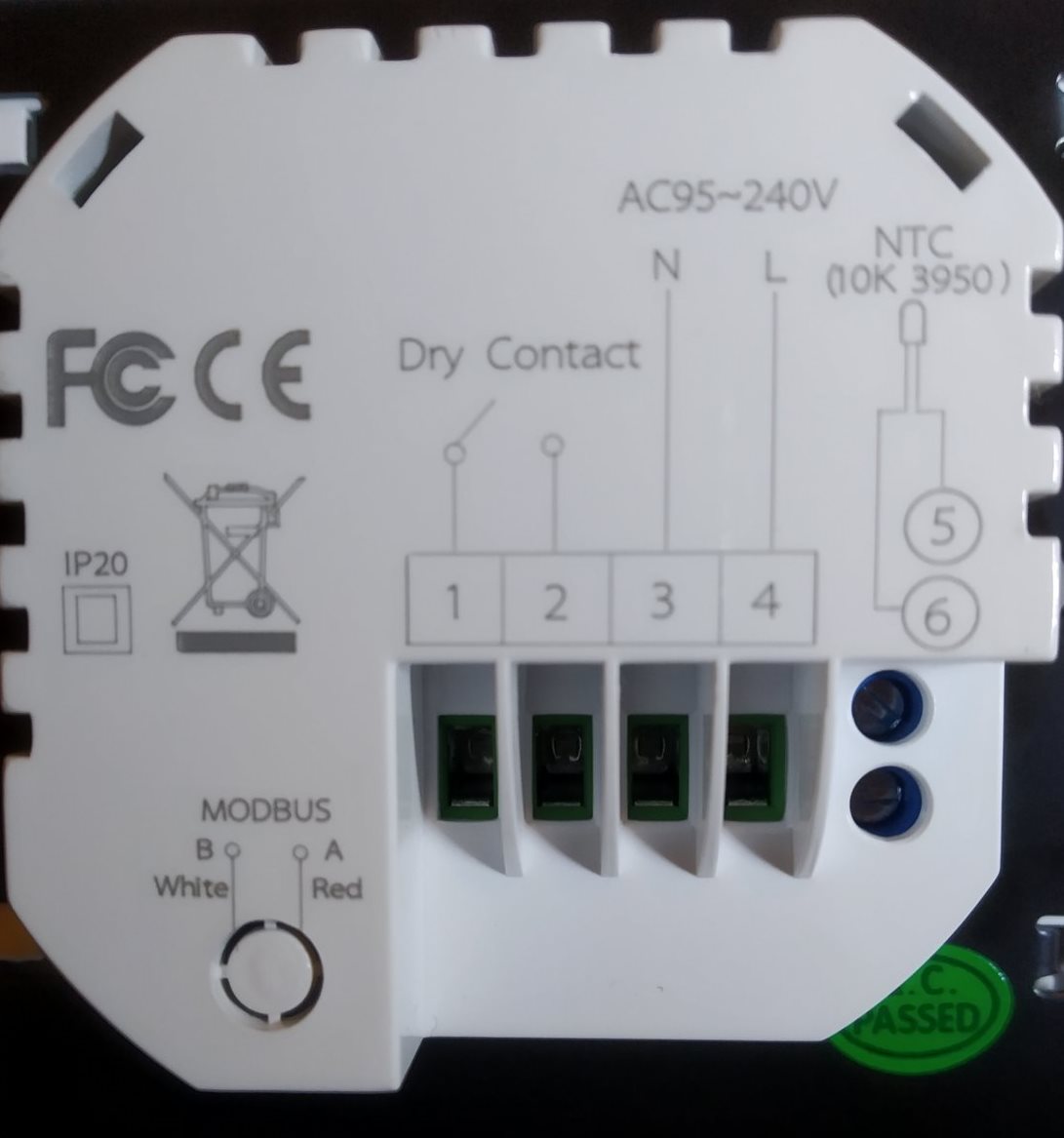

I am looking to change to a moes BHT-002-GCLW. bu I'm confused slightly by the earth in my old thermostat..
Am I correct in thinking the following:
Old Live to pin 4
Old N to pin 3
old yellow(3) to pin 2
Old earth not used (omitted)
Jumper from new pin 4 to pin 1
Any advice appreciated!
