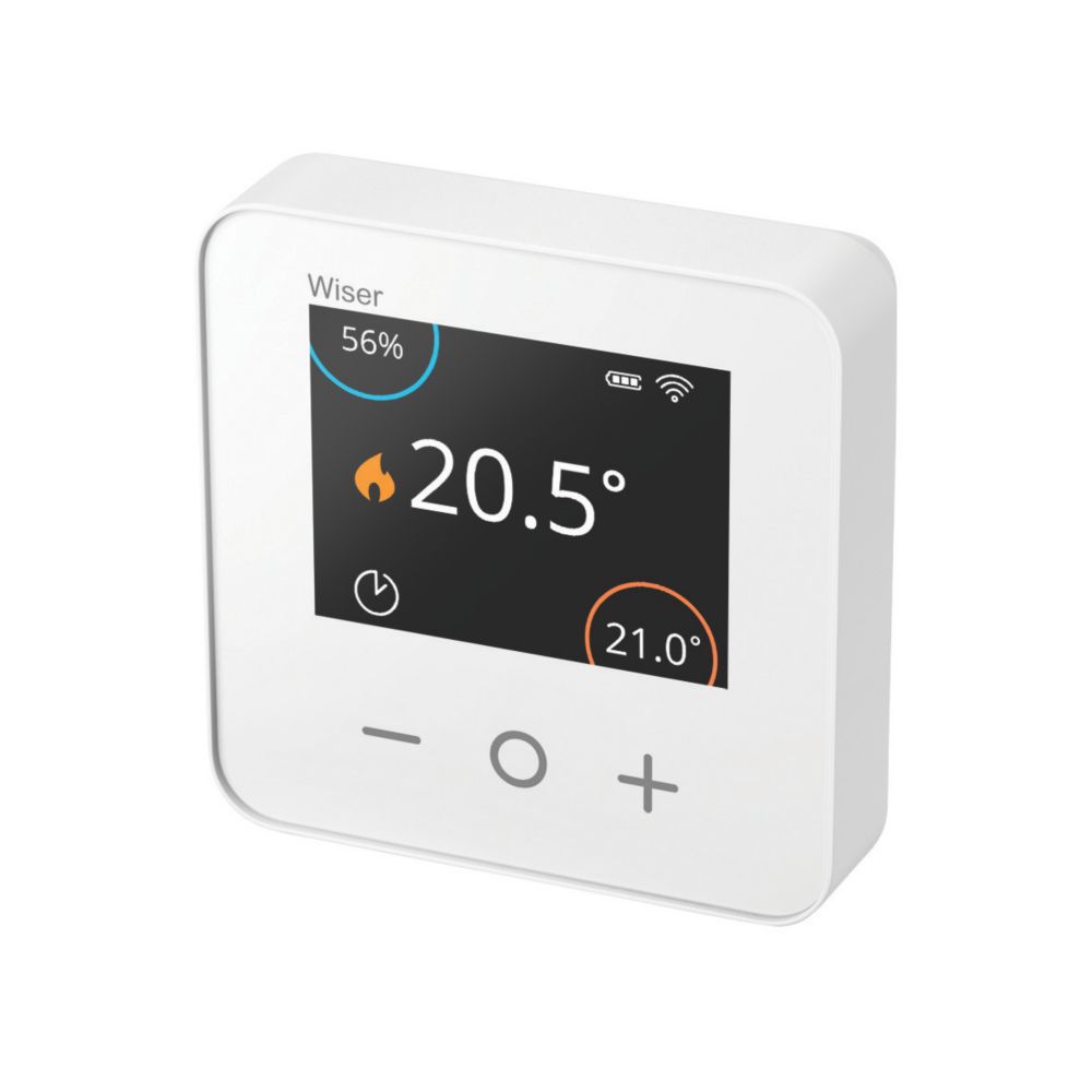

You can use an external thermostat to control multiple smart TRVs
This would normally be used where you have multiple rads in one large room.
The starter kit comes with one external thermostat with the hub
You can add more external stats. If you only have one room with multi rads and want to group them then one will do.
