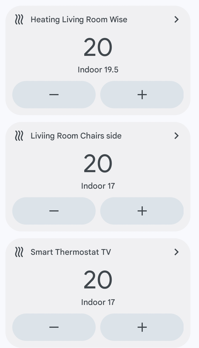

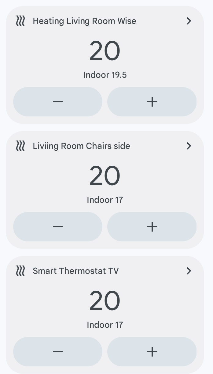

My Drayton Wiser thermostat base connects wireless to the router, clearly wired to the boiler. The thermostat is wireless, and battery powered, as a result it does not auto light up when you approach it, or use the built-in PIR to detect when you are home. If using geo-fencing, it uses IFTTT not the built-in system used by Nest, but to be frank, Nest left me cold, so all in all seems to work better than Nest, in the main in that it is placed where it needs to be, not where the wires allowed Nest to be fitted.
But I still use the Nest to work DHW, and I control them both using the Nest Mini's, So just today tried "hey google set living room to 20 degrees" and pleased to say all three devices worked together View attachment 372231one Energenie TRV head, one Kasa TRV head, and the Wiser wall thermostat all changed to 20ºC, did not even know I could do that, until today. The main reason to moving to Wiser is the TRV heads can be linked to the hub, not got any yet, but on my to-do list.
I was told Nest Gen 3 worked with Energenie, well I have failed as yet to get them to work together in any useful way. I got Nest Gen 3 as it allowed all hard-wiring except for internet, and it does mean two wires thermostat to hub allows me to control both CH and DHW, but lack of integration with TRV heads has resulted in my adding Wiser as well.
