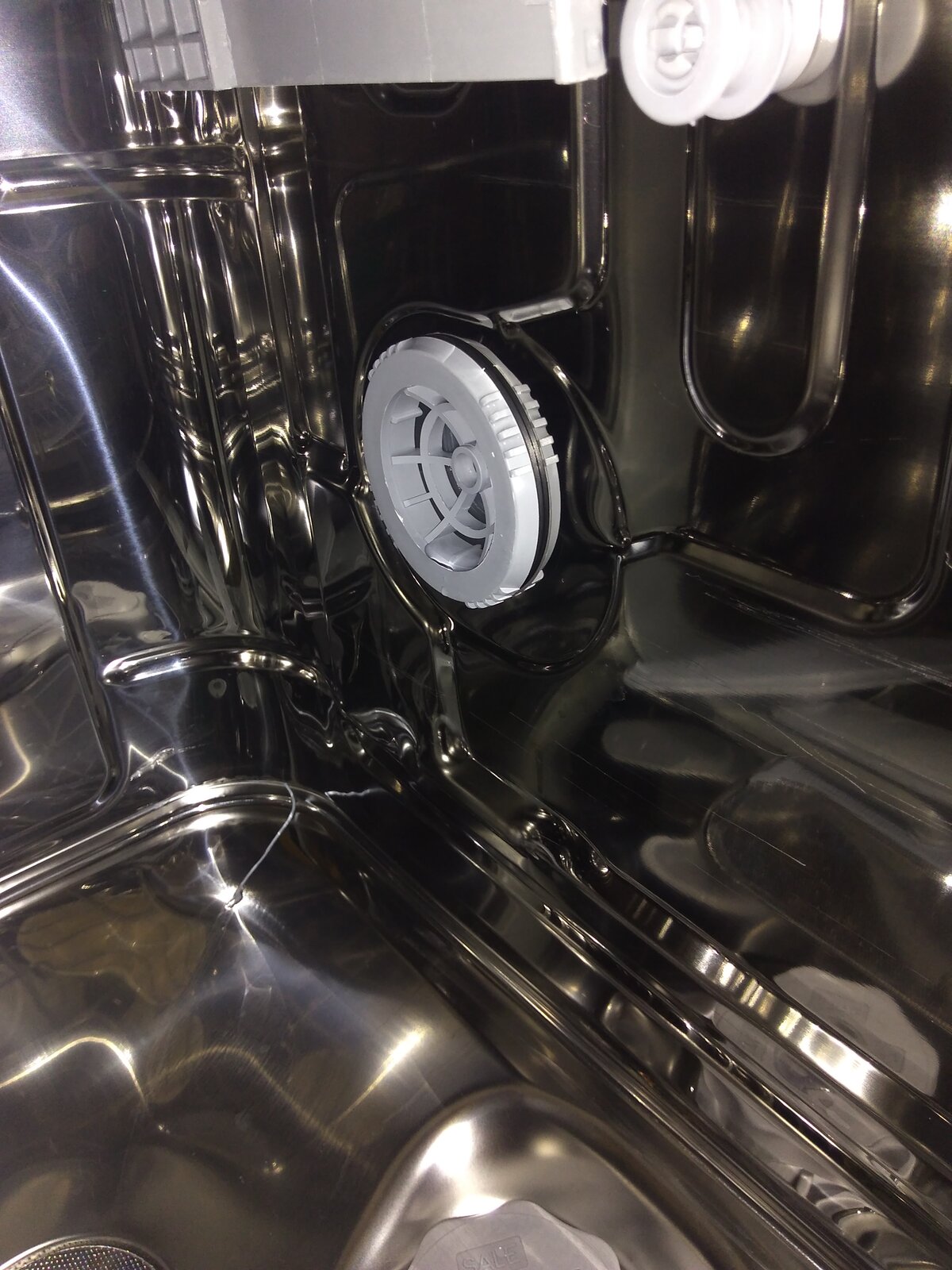

I ran another cycle and checked at the end. The base was empty. I had a good look inside and could see a slow drip coming from an outlet - see picture which shows the outlet. You can see water in it. When I turned the water off at the tap for the inlet the drip stopped.
Update - have left the dishwasher for a while after thoroughly drying water from suspect outlet. No further leaks but level in sump where filter sits is very slowly filling. Definitely water coming in. I suspect the shutoff device fitted somewhere on the inlet. Anyone seen this before?

I decided not to take a picture of the waste hose as I believe I have eliminated it as the culprit. While the machine is powered off and the tap is turned off no water enters the tray at the bottom and the sump area around where the filter sits is dry. Still with the power off and the water inlet turned back on the sump around the filter at the bottom can be seen to very slowly fill with water. To me it sounds like the solenoid is the area I should be looking. Thanks to all for your help, I will report back here when I have it fixed.
Took the back off the dishwasher and couldn't see a solenoid valve, the inlet pipe disappears inside the unit. But, there is some kind of device the water passes through where the inlet hose connects to the tap. Found out this is the solenoid or as it is correctly called an "Aquastop". A sealed unserviceable unit encompassing the tap connection, the solenoid, an outer hose cover, the inner hose and and electrical wire with a connector at the machine end. I priced a new Smeg Aquastop online and they varied from AUD$219 to nearly AUD$400. Ouch.
Nothing for me to do, called an appliance repair guy who fitted a generic Aquastop which including a call out fee and labour set me back AUD$280.
