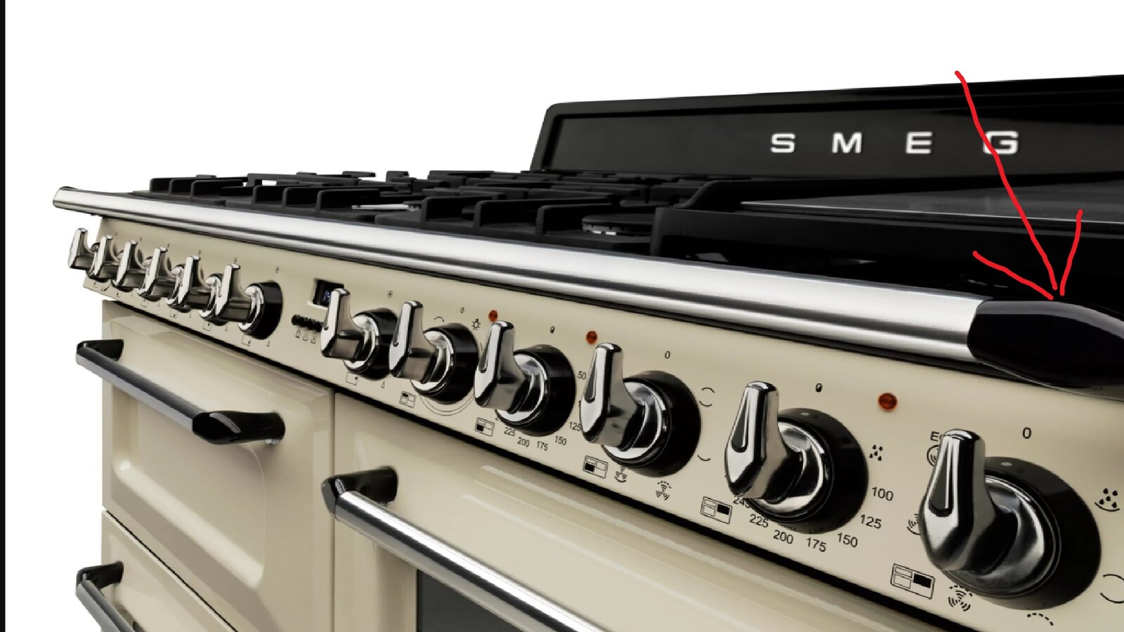

My mate has a Smeg TR4110 range oven. The long handle that runs the full width of the front has fallen off on one side.
The red arrow shows where the handle is now missing a screw. I am not sure if I need to pull the oven out to remove the top or whether I need to remove the section where the knobs are to get access to the machine screw. Even if I do either of the above, I am worried that the fitting at the end of the handle may be broken inside.
The third page of the schematics don't seem to help much

Ideally, he would like to keep the handle but if the housing in the end is beyond repair, he would rather that the whole handle was removed- which I guess means that I still need to gain access to the machine screws.

Looks to me like you need to remove the rear part with SMEG on it, probably screwed from the back down into the panel that holds the burners & pan supports. It looks like the same screws hold down that same panel which with the pan supports & burners removed should then either lift off or slide forward & lift off. You will then have access to the fixings for the rail ( 98201,97389 & 97390)

Given that the handle is loose do you think that he should just live without it? By that, I mean do you think that the inner thread on the handle is effed?
