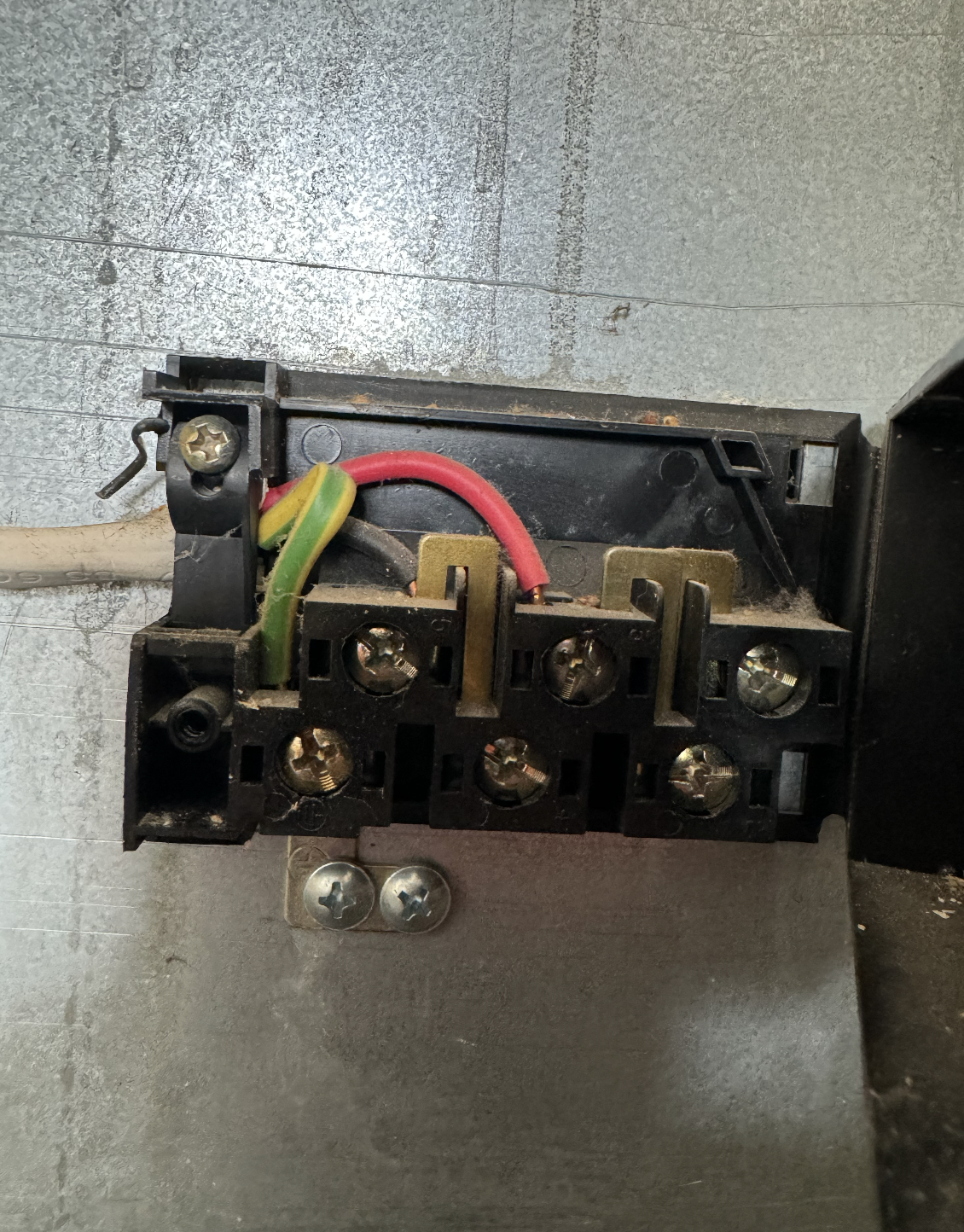

Hi,
While removing the back plate to replace the element on my Smeg SUK62MFX5 oven - 3 of the live, neutral &
earth connectors became unplugged (before I could get a photo - I know!)
There are 2 live, 2 neutral & 2 earth. 3 are still connected -

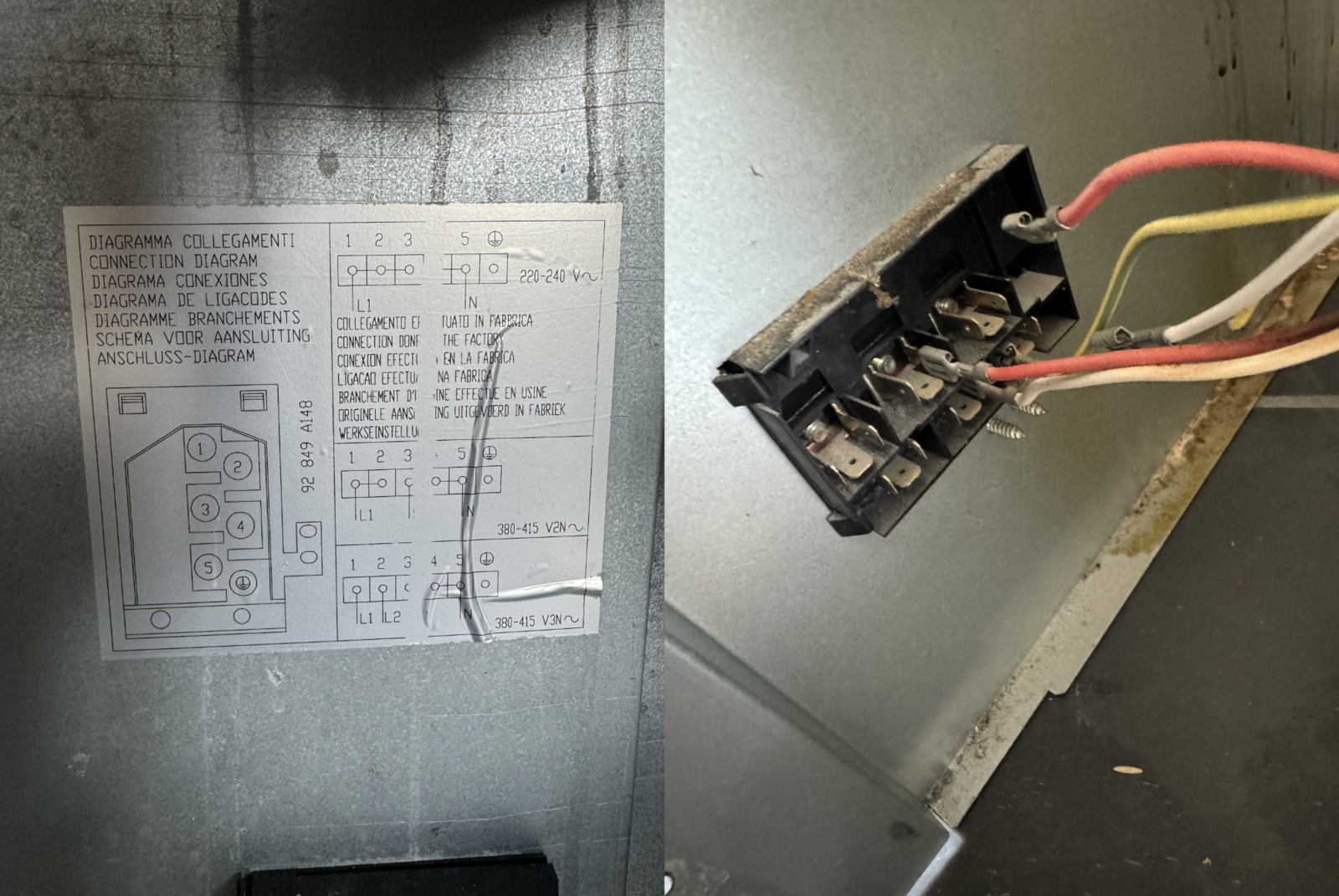

Had a look at the diagram on the back but as luck would have it has worn off in places from cleaning fluid. urgh!
Does anyone here happen to know the correct plug placement? or have a picture of the diagram I can follow?
Any help would be much appreciated before my partner gets home :oops:
kind regards,
Bob

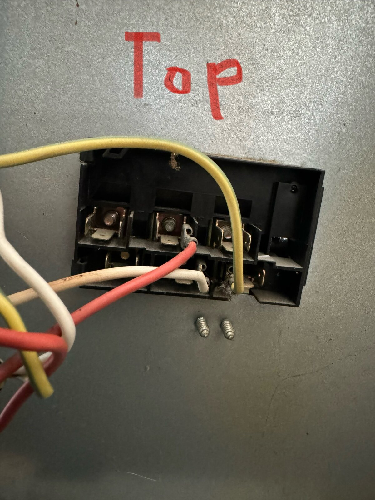

ok - so I've opened up the circuit box on the outside.
live goes to 3 - negative goes to 5 - earth to earth obvs!
I'm guessing that connectors on the inside need to match up accordingly?

*FIXED*
Matched them up with the external wires & it seems to work :)
