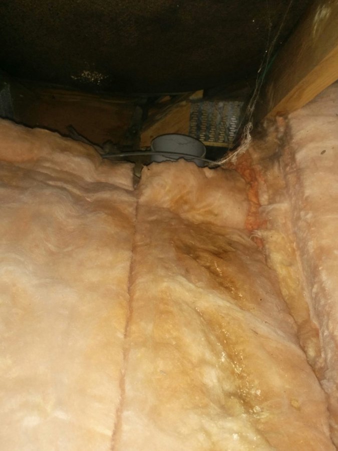

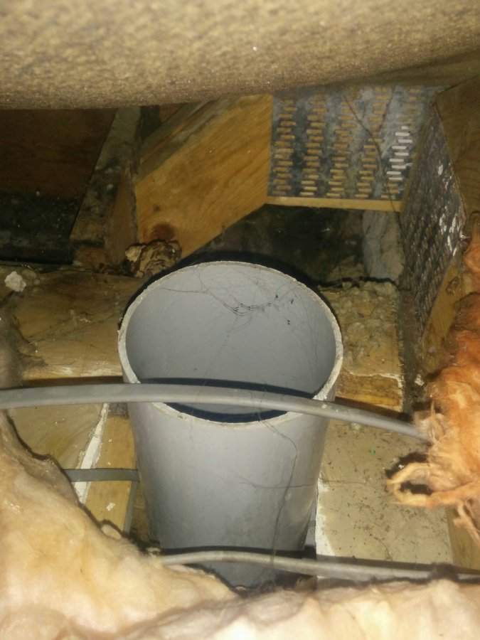

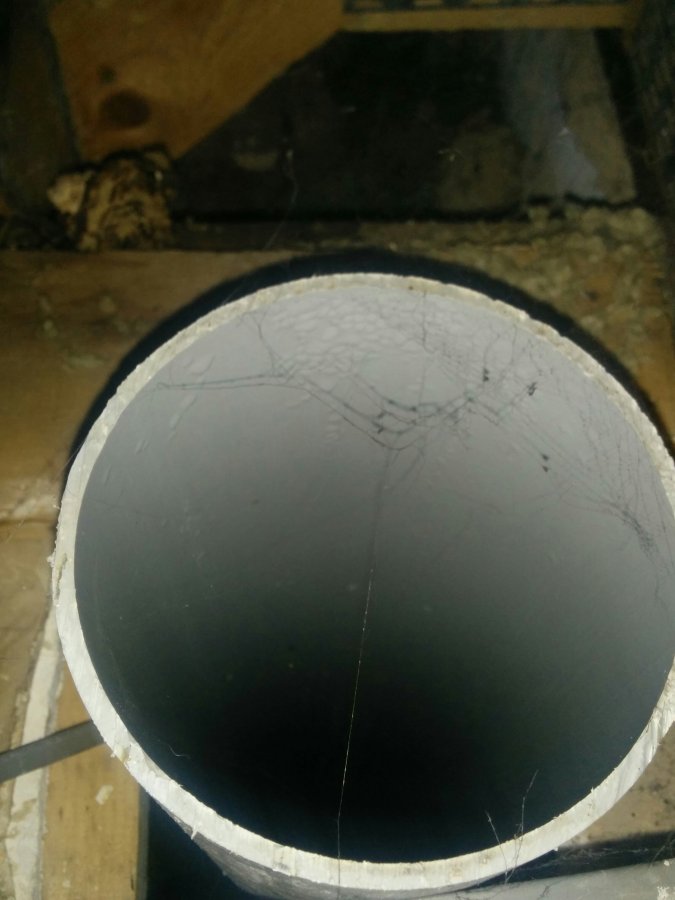

I've look all over the roof and there's no pipe sticking out, I assumed it was therefore ending in the loft so i had a look up there. I've found a pipe terminating in the loft pretty much above the area of our bedroom where the smell is first smelt so i'm assuming this is the soil pipe. It's pretty had to get to as i don't have loft boards down in that section but i managed to grab a few pics (hope i've attached them correctly!), does that look like a soil pipe?
If so, should there be anything on top of it?
When i was in the loft and my wife ran the tab in the en suite i could hear the water running in the pipe no problem so it's definitely connected to the en suite in some way.
If that is the top of the en suite soil pipe then I am 100% sure it should not be open like that. Shouldn't it have some sort of vent??
I'm a bit concerned as to why that has been left open like that, I'm wondering if it's a classic builders cock up, and that pipe was always intended to be continued through the roof. The en suite sounds like it is terminated with an AAV inside the boxing, which isn't a problem usually. I'd be a bit concerned about fitting an AAV to that open end at present, until it's established what ventilation is provided, (if any), elsewhere on the system.

Basically a soil pipe should either be taken to an open end to vent externally or be fitted with an AAV to terminate internally. Rules usually dictate the highest point of the drain should be open to atmosphere, to allow any gases or odours to safely and unobtrusively escape from the system.Other connections lower down can be terminated with an AAV,
Without seeing the layout of the property and drainage system its difficult to tell, but chances are the other bathrooms may use independant stacks and enter the drainage system further down. Using the ensuite would displace air in the drainage system, and possible give rise to the problems you are experiencing. I would get a plumber to look over the property, and if there is not currently another open vent, I'd bite the bullet and get that open end in the loft extended to penetrate the roof and vent externally.
