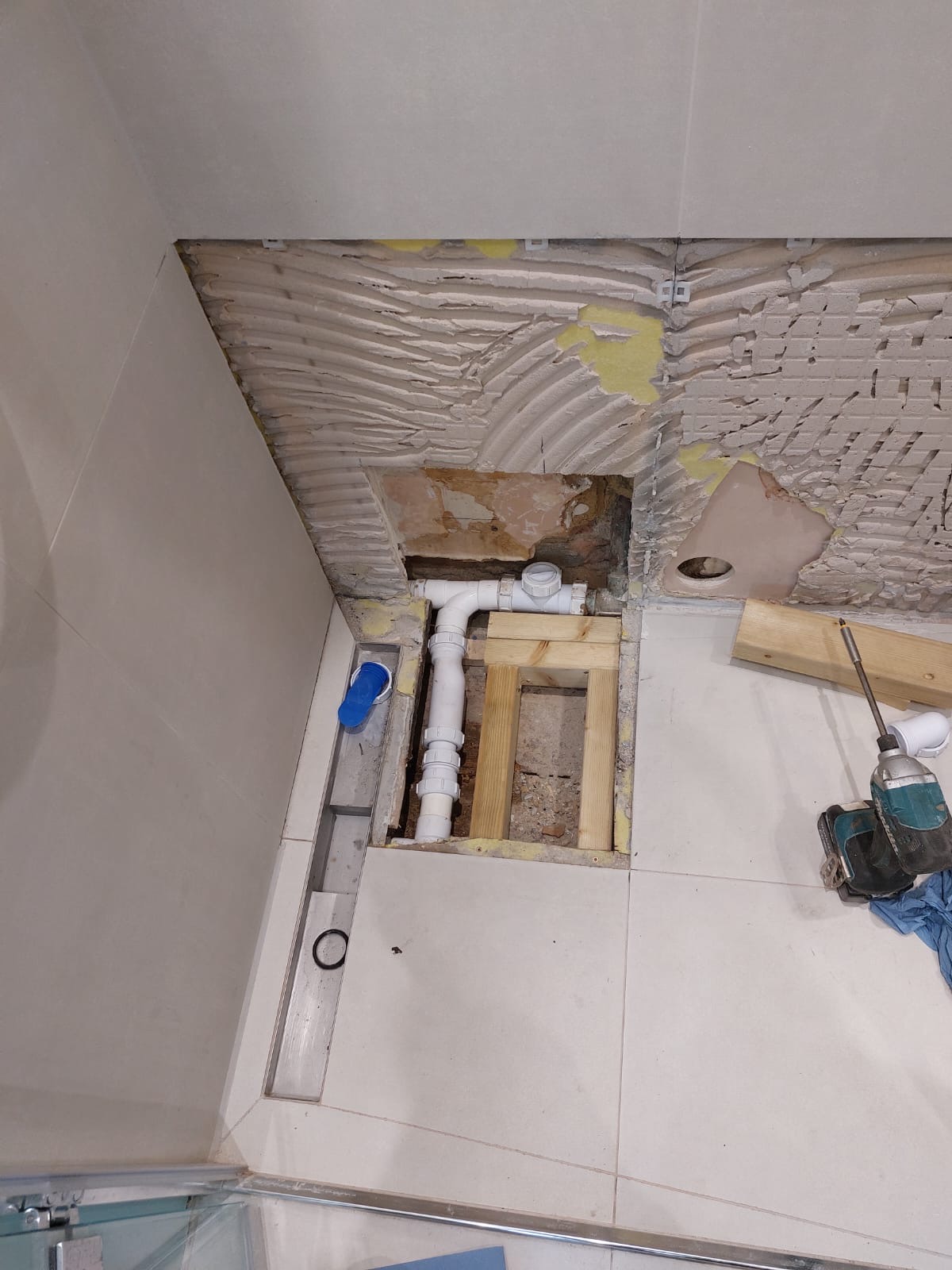

Hi all.
Yet another shower drain smell problem.
I think this one is related to my neighbours plumbing coming through the wall and sharing my shower waste pipe
I’m having a problem with horrible smell coming from our shower that was installed a couple of years ago. Had 2 plumbers look at this and one has added a non return valve to the shower pipework to stop air coming back in.
The problem is their is not sufficient space under the shower for a trap and we have a linear drain.
I don’t think the non return valve is working because every couple of days or less the smell returns. It then goes on its own but it’s pretty foul and I don’t like to think what.
oh it’s a shared Victorian house divided into flats and we are raised ground floor. I believe we all share the same soil pipe that is in the corner of our bathroom boxed in.
im concerned the nrv under the shower hasn’t worked and also aren’t they supposed to be maintained regularly? Ours is tiled over.
Our shower waste runs past the toilet and then both enter the soil pipe I believe. the basin, washing machine and kitchen sink run into the large toilet waste pipe.
The fall is ok from the shower as it runs away but it doesn’t if we fit the anti hair piece on the drain.
can anyone help please?!?
oh also there are 2 pipes coming from the flat next door joining our shower. One waste pipe before and one after our shower waste. that all goes to the main waste.
I think there may be siphoning but I’m smelling now something and the shower drain has some water in it.
the nrv isn’t stopping smells though

Fit a raised shower tray that you can fit a trap to.
Thanks. I did think of that but it would mean refitting the shower glass enclosure also. Would that still resolve the issue if there is syphoning happening? I’m not sure why the smell comes and goes.

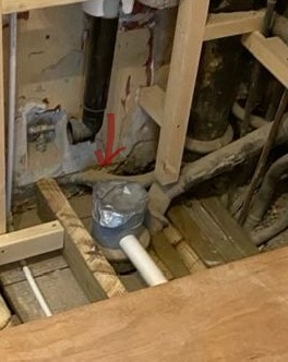

Here is the toilet stack plumbing
The white pipe is from the basin and has been changed now. The toilet waste has been changed to a black fitting with more secure fittings as this one was leaking.
The plumber attached this old one with silicone. Madness.
Could this replacement have added to the issue ?

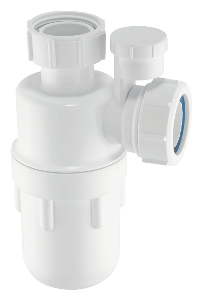

Perhaps suggest an anti-syphon waste trap on the sink outlet?
I had exactly the same issue. On flushing, the vacuum would pull the water out of the shower waste leaving the plug open to the sewer.
Works great.
Works great.
We have one of those under the kitchen sink to stop gurgling when the tumble is on. (Works a bit)
Do you think adding one to the bathroom basin will help the shower as it’s on the other side of the bathroom and no smells from the basin.
Also there is some water in the shower drain and I still smell but only sometimes.

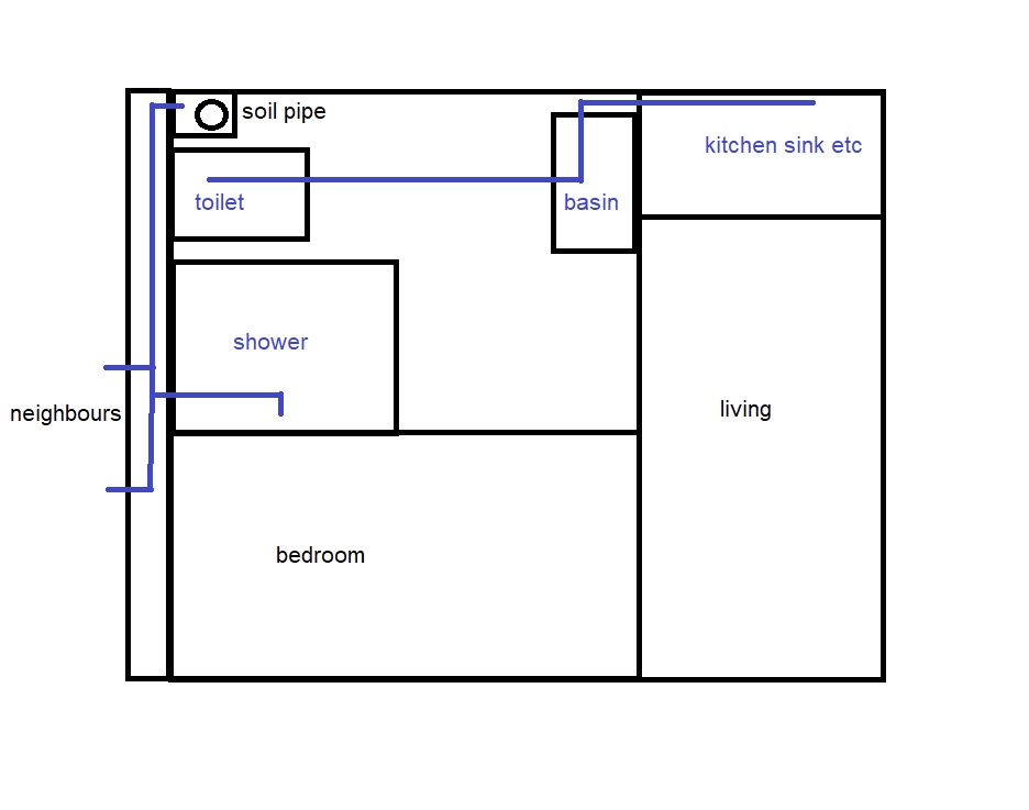

Am I smelling something caused by actions of my neighbour who shares my bathroom waste or maybe above.
It’s driving me insane
Here’s the layout
