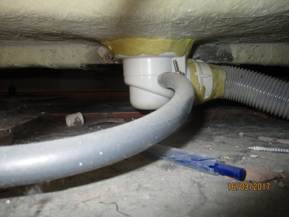

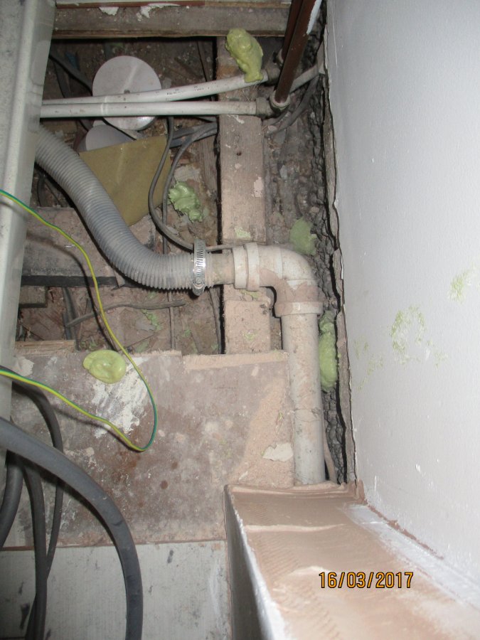

This is the space behind shower. What would be the best trap to try and get fitted ?
And a photo of the waste looking down in the shower tray?
There should be an inner cup/tube that creates the trap. Dismantle whatever is inside the tray waste by lifting bits out and show us pics of the bits that make it up.
Where does the thin blue pipe come from, and why is there some much plumbers mate around the fitting. You could fit a Hepvo trap at the between the greay and white pipe in the first picture.
