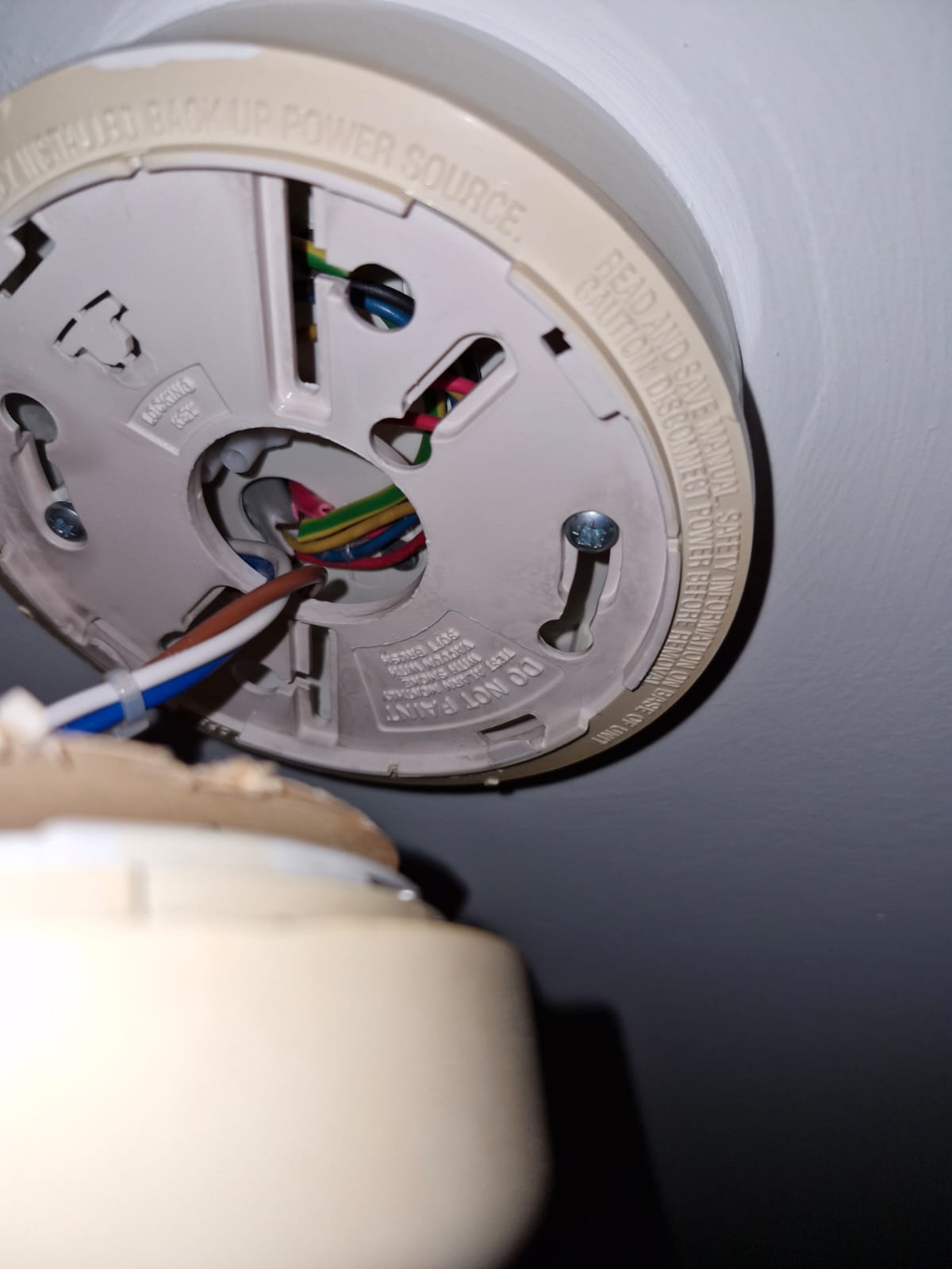

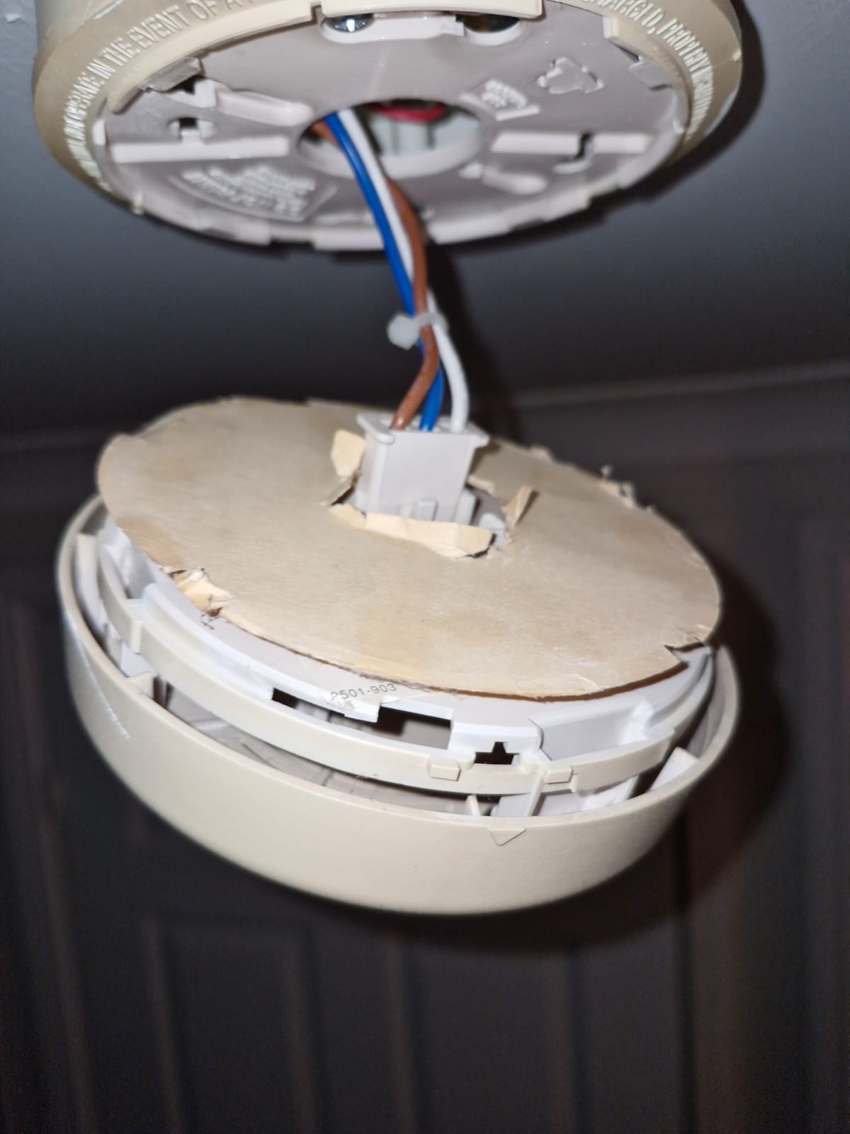

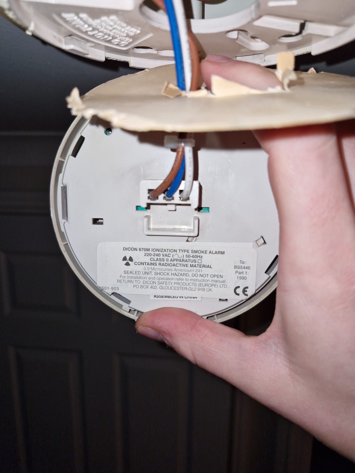

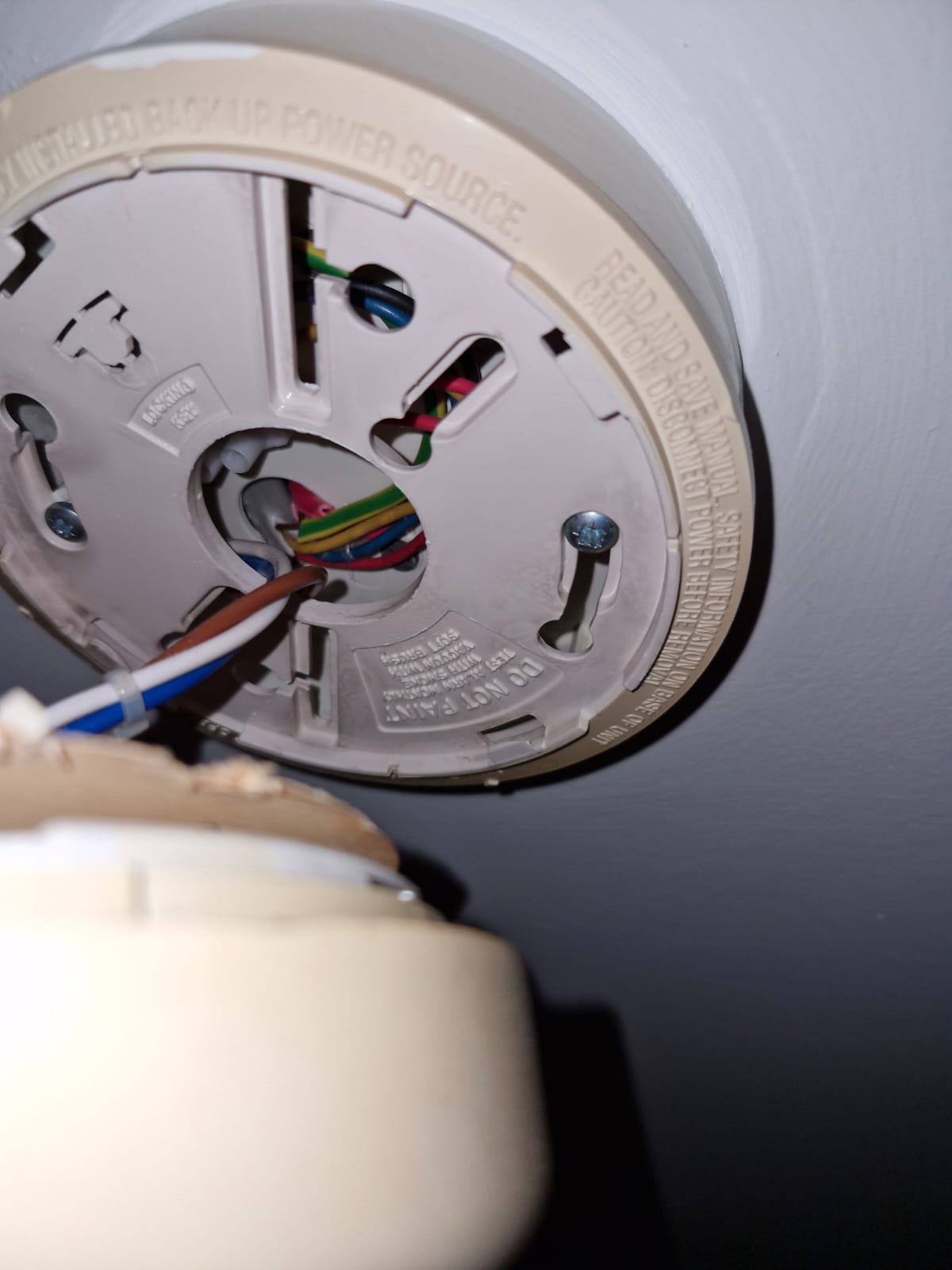

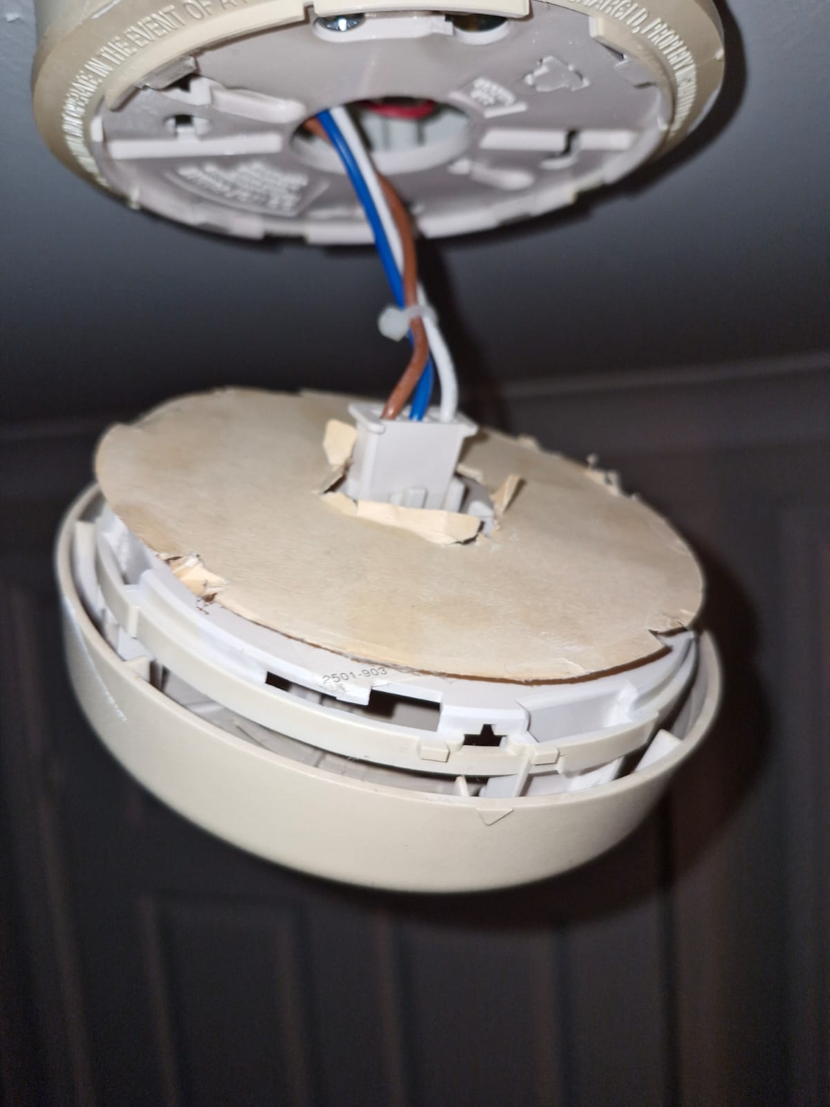

Hi all
Hallway smoke alarm has started to beep last few days
Been in this house couple of years, smoke alarms in my old house were just sticky back taped to the ceiling so thought replacing would be easy
Cannot see anywhere where a battery could be replaced in this alarm?
Thoughts and any product recommendations much appreciated
Many thanks

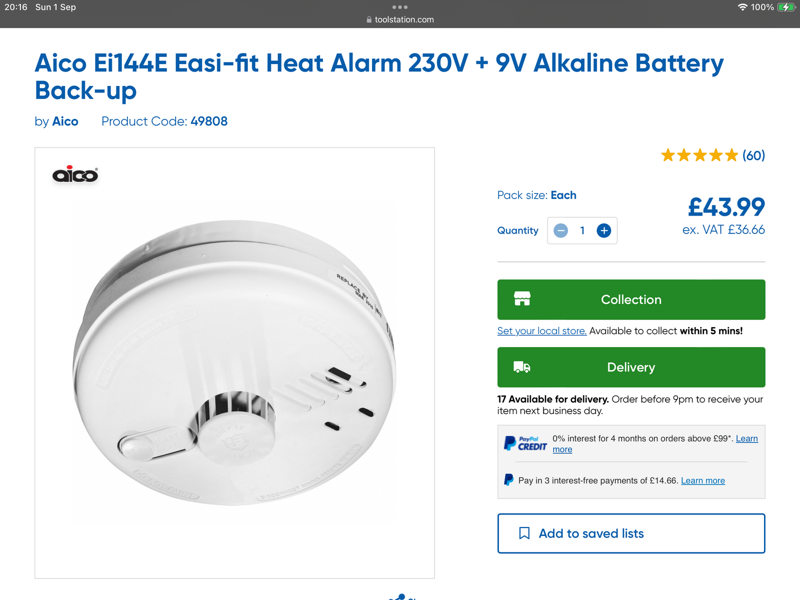

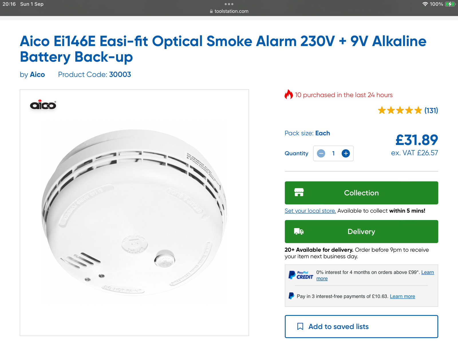

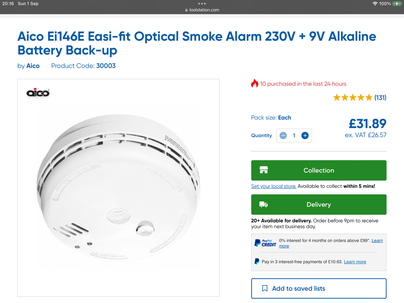

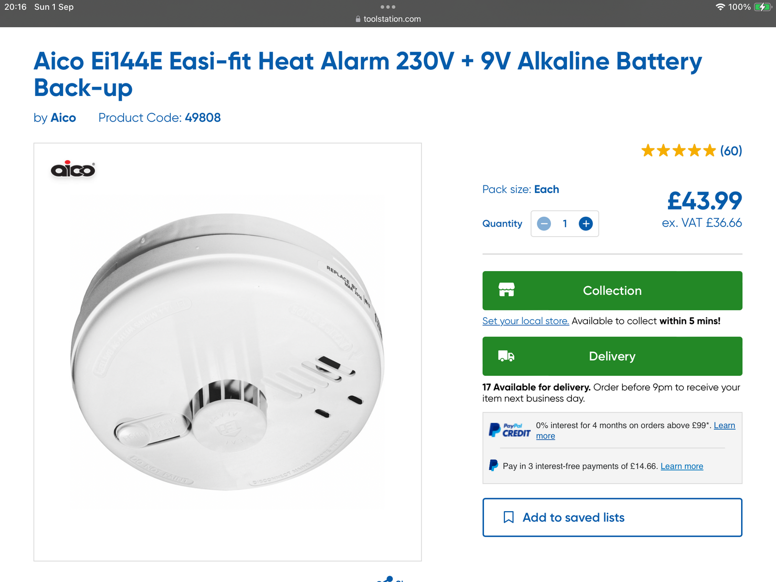

AICO ….. swop all the smokes/ heat detectors at the same time , these are dicon / BRK units
Toolstation

That is a sealed unit. Can’t replace anything on it
Aico are the best, not the cheapest, but the best
