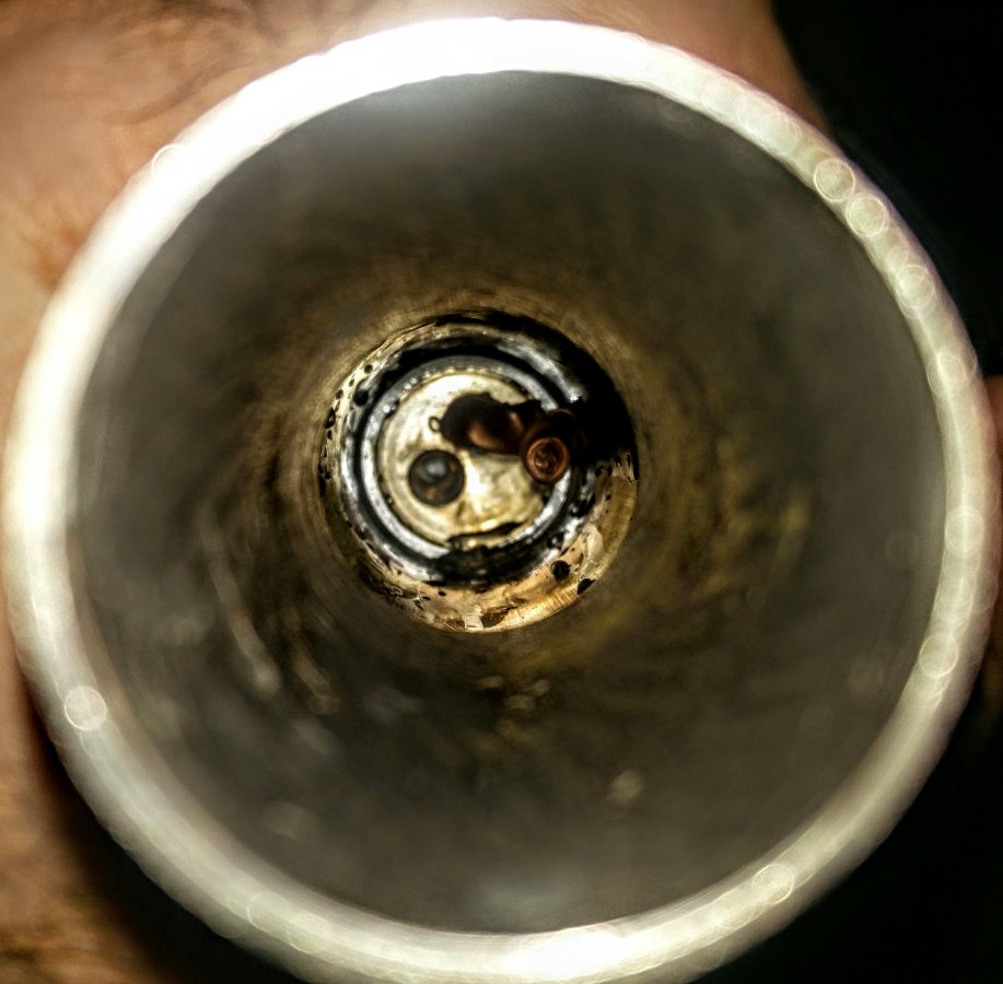

I needed to remove a copper tap tail from a high rise monobloc tap, to get the tap off. The tail has snapped off about 100mm inside the tap body. It had a nut brazed on to it, and when I turned the nut it looks like the pipe twisted and sheared instead of the connector unscrewing.
Any suggestions for removing the tail? I could try hammering a deep socket onto the pipe and turning with a ratchet but don't want to make it worse.

Thanks. The mixer is off the sink and has been replaced, so the basin is functional again. I would like to salvage the tap if possible, do you have any ideas how? I had to unscrew the tail further where I did as it attaches to the tap body quite deep inside the base.
Picture attached. It's actually more like 250mm inside the tap body.
That's the devil's own job there.....you'll have to lose the remains of that copper stub, and then get in there with a splined extractor - or maybe a short tapered type that's used for torx fittings. Google splined extractors and you'll see what I mean.

If you can remove the copper stab or straighten it out you may be able to get a monobloc socket onto it. Maybe even use the socket to help straighten out the copper. It will be a right pain in the ass and I doubt it will be worth the trouble.
