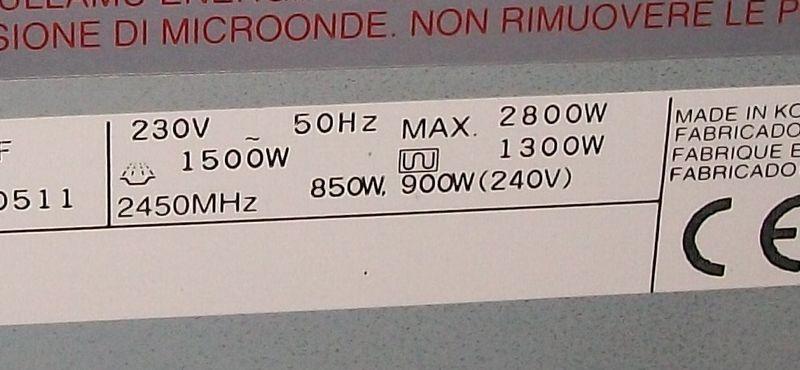

So much for consulting the rating plate !
4 Nov 2010
6,181
662
Cumbria
Testing/inspecting the appliances in the house I've just bought, all went well until the last item - a microwave in the kitchen. Turn it round to get the details from the rating plate, and this is what I found :confused:
The mind boggles at how they came up with quite so many ratings.
I figure it's 850W or 900W (230V or 240V) as a microwave, 1300W or 1500W as a grill, and 2800W max overall. Except that 900+1500 came to 2400 when I was at school - so dunno where the 2800 comes from.
But at least I had one proper fault to fix - I reckon a 170W freezer shouldn't have a 13A fuse in it's plug, although it's cable does look like it's sized for it.
1500w microwave, 1300w as a grill, 2800 max, 850w/900w refers to the output power it would appear
Agree with skenk.
Also on the freezer most come fitted with a 13a as per the manufacturers specs. Start up currents, defrost cucles etc, Same with fridges and most TVs on paper dont need a 10A fuse for an 85watt power consumption but thats what you get.
