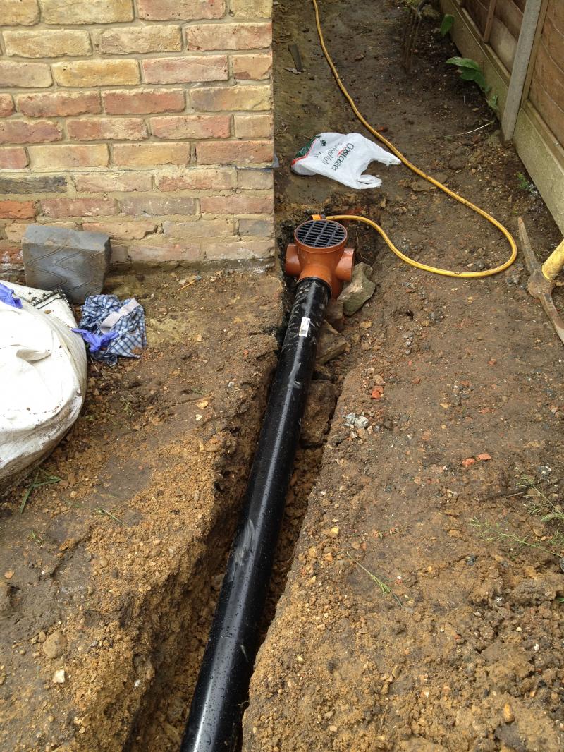

Hi, maybe I know the answer to this already however I would like your opinion.
I've dug a soakaway 5 meters from my extension and started filling it with rubble, maybe not the best way to construct one but it is only for a small rear extension.
Anyway, my dilema as seen in the photos below. After digging the trench for the pipe and drain the pipe work looks very close to the surface?
Is this the norm? Should I be putting a S bend of sorts to lower the pipe further into the ground?
Maybe the type of drain thing I have is incorrect?
you opinion would be great appreciated.
Regards
Byron
You could do away with the gulley and use a 90' bend down lower and come up with some more black pipe. Sure you can get a grid cover that would fit over the 4" black pipe.
You would need to dig some more soil out mind, at least this would give you some more depth.
Our local B.C insist on 300mm cover over the pipe at its shallowest.
That soakaway does not look like it begins at 5m from the building.

I'm not sure who did the brickwork as it he was hired by the PM. I think it's pretty naff too if that's where you are going with that hah
The soak away is just shy of 5 mtrs from the building.
I guess the cover is so people know the pipe is there or is there some other bizarre reason for that?
If same cover suggested above then I'll do some research, just hope its not a ballache to fit!
