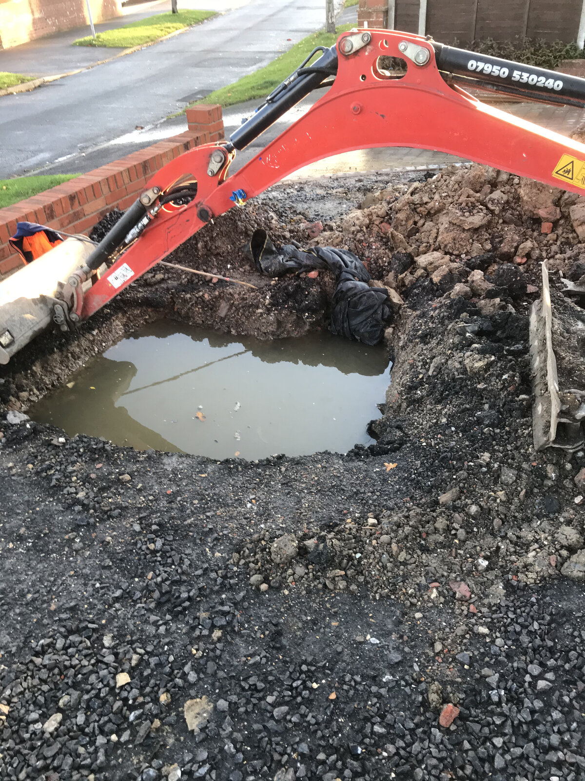

I can’t help, this is soak away number 2 in progress
I've no experience with soakaways but your pic looks lile you're uphill a bit / on higher ground, compared to the road?
Would the water table be that high?
Saw an episode of Grand Designs once, the amount of water on site meant a massive spend on deep foundations.
After they were laid, turns out there was a leaking water main causing it.
Not saying this is that, but, from the pic you look like higher ground (unless you are in a valley) and unless flooding is commmon place, seems odd?
Water ran into it from soak away number one which is actually under the digger. 8 crates were used and now laying french drains to try and keep water from flowing down the drive and across the pavement. You can see it in the background of the photo. I believe this is actually the water table, as we are on clay and there was a natural pond 25 metres north west about 100 years ago.
Dont want to highjack this thread but for info we are on a rise approx 3 metres above the roadway. Both front and back gardens can get water logged if we have heavy rain. The photo was taken after 3 dry days following a week of heavy rain. The drive now has an aco drain to catch the water and a pipe to lead it to the soakaway. The damp proof course at the rear of the property is about 150mm and at the front about a metre above ground level.
