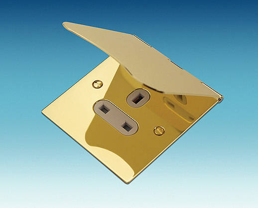

as i understand the height for sockets is 450 in a new premises, i have been asked to put floor sockets in and was wondering if this is ok to do in a house?
We have fitted floor sockets in some high spec domestic properties.
They are used for example to supply a table lamp or laptop where the room is big enough that the furniture is not near the walls, and trailing leads are not desired.
We use the thin flappy ones. They do not actually look as bad as you might imagine in a domestic.

well, that hardly helps my cause does it? it says 450 up a wall, mentions nothing of floor space.
I think you've answered your own question. If you're installing wall mounted sockets they have to be within the mounting zone. If you're installing floor sockets they can go anywhere.
IMO your customer would be foolish to have only floor mounted sockets as this would de-value the property but in the end it's their choice.
My reccomendation would be to wire the floor sockets as spurs from a switched FCU on wall. This will enable relatively easy de-powering in the event of damage, floor cleaning or spillage of liquids into the socket.
A radial specific for floor sockets would serve the same purpose.

note that there are two basic styles of floor socket, the flappy ones (which judging by what i've seen often get the flaps broken off and i would consider a trip hazard if placed somewhere people are likely to walk) and the floor boxes where the sockets are far enough below floor level that an appliance can be plugged in and the lid put back on with the flex coming out of a neat hole.
I don't see modern sockets as posing much risk to babies, i can't imagine them having the strength or skill to get past the shutter mechanism (hell has anyone worked out how to get past the shutter mechanism on mk's modern sockets without using bits of plug?).
IIRC the building regs just require that reasonable provision for disabled people should be made. I'd think that having plenty of sockets in the reccomended zone would satisfy that even if there are also sockets outside that zone.
