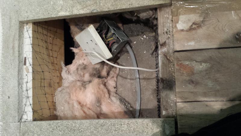

Hi All,
Wonder if you can give me some advise.

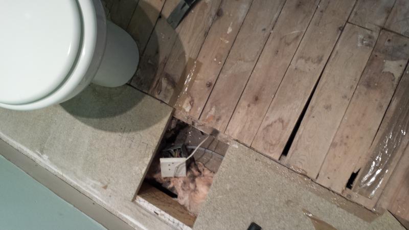

I'm in the middle of replacing the floor in the downstairs toilet. I started by lifting the old floor and fixing the squeaky floorboards and found this:
How should I deal with this? I was thinking about using a waterproof box and putting some sort of connector in there to terminate the connection but really would like other peoples input.
Mark
Hi, yes your solution is correct but you must use a maintenance free type, i.e. Hager or Wago 20a or 32a will be fine. Obvously don't locate it under the shower tray ! I would fix it to the side of a joist.
The ideal, of course, would be to find the other end of that cable and disconnect it at that other end. Failing that, something such as you suggest is probably the best alternative.
I would not have thought that it really needs to be maintenance-free, given that there is seemingly no 'joint' involved (assuming there is just a single cable), does it?

There's a cable coming in from both sides by the look of it.
I hadn't noticed that either.
But I had noticed these two:

Obviously if the cables are joined with a junction box then the terminals have to be maintenance free.
Are the available boxes for the "maintenance free" terminals also water proof. ?
Personally I consider any junction under a bathroom floor will be a hazard unless the floor is totally water proof

Well, yes, I imagine we all noticed those two - however (again, I suspect, like yourself), I had, perhaps naively, assumed that the white flex 'disappeared off' somewhere and had nothing to do with the socket and T+E.
If those two cable are joined, I would want to do a fair bit of investigating - to find out 'what is going on'! I also suspect that it might be difficult to find an MF JB which was designed for flex, but I may be wrong about that.

I assumed nothing of the sort - I assumed (still do) that it's a spur from that socket.
And I'm pretty sure it's round flex.

Isn't it just a twin and earth viewed sideways on?
I initially wondered that, but I eventually concluded that it probably was round, since, with the twists and turns I would have expected to see the 'side' somewhere if it were flat T+E. However, maybe I'm wrong, and you are right!

I would, for a start, disconnect it and see what stops working.
