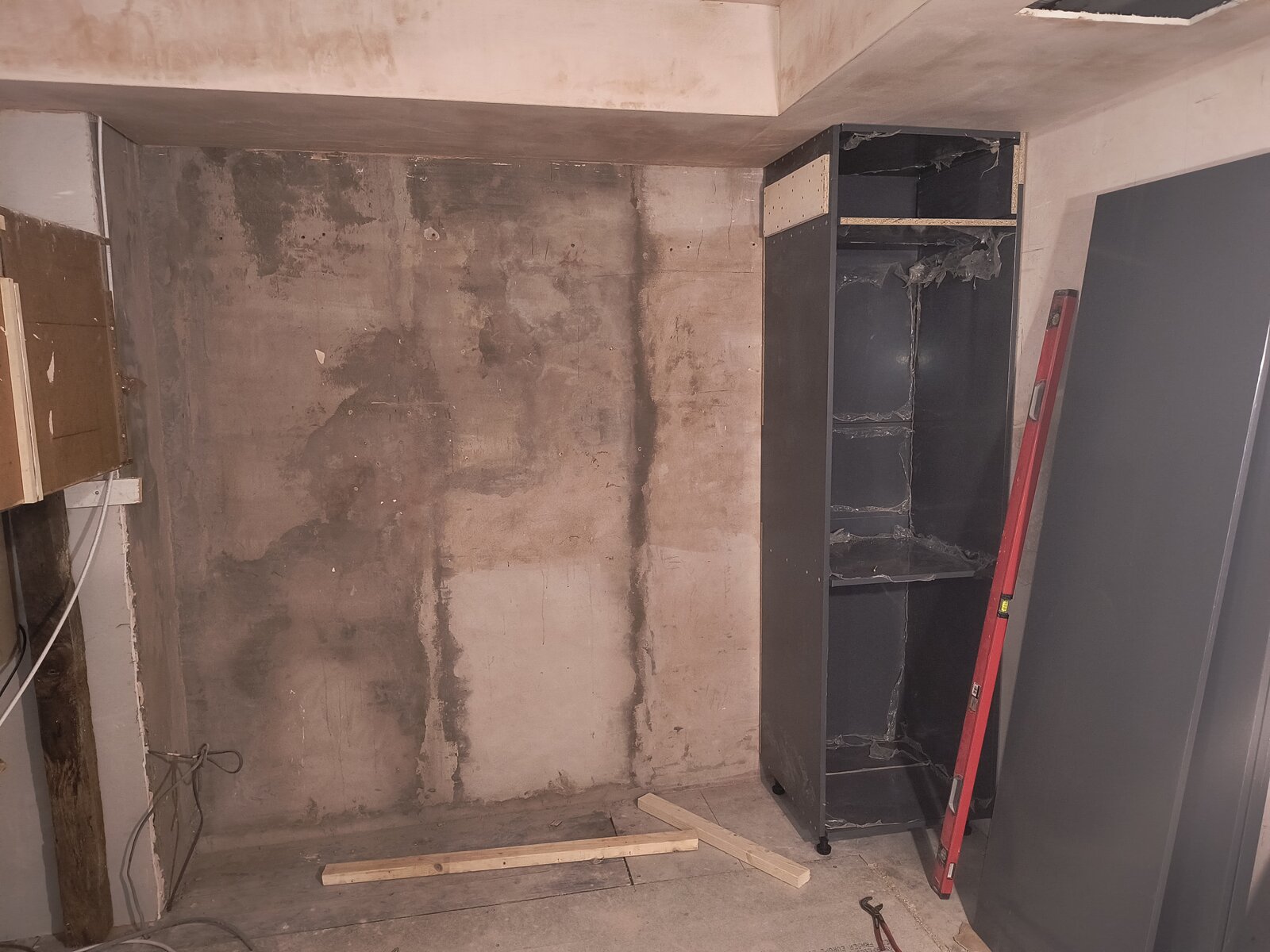

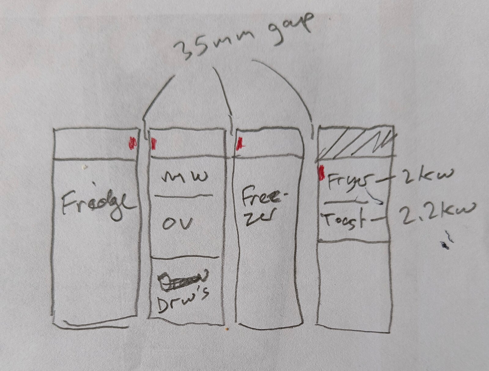

Is this allowed? Integrated microwave, oven, fridge, freezer, etc.
Can I use drywall boxes to flush mount them into the carcasses? The way the kitchen is being built means there will be sufficient depth.
There's no electrical regulation sgainst it I believe, but the guidance notes regarding building regs, I recall mention they should be fixed to the fabric of the buillding
It's fine socket in adjacent cupboard I'd just put a surface box rather than a fast fix.
Most kitchens are there for 20 years or more that's part of the building I'd say.
The key is to make sure that they are all accessible. Not behind walls, heavy appliances etc
It's wall to wall, floor to ceiling units definitely part of the building fabric - each one has a small cupboard above where I would could locate the accessory.
Oven has it's own radial.
I think the air fryer and toaster (on pull outs) would be ok to share a double socket but my assistant keeps saying I'll be making air fried sausages on 4 slices of toast!

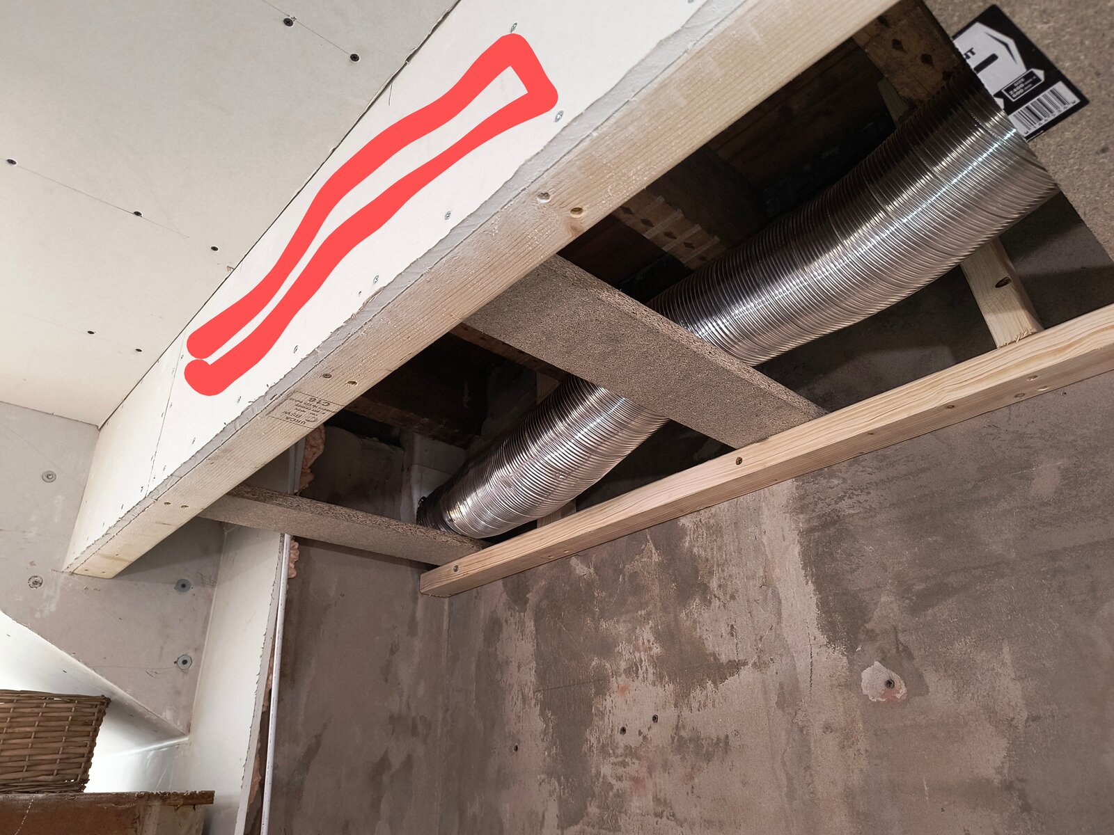

How are you going to ensure sufficient airflow / ventilation around those appliances at the back with no space above ?
Well spotted! Just pondering this - the "ceiling" is just a big box to house the extractor ducting so I'm going to modify the cabinets so I can get the required top airflow into there - I don't know whether this will work - it's a big, but closed space. Plan B will be vents on the front:
