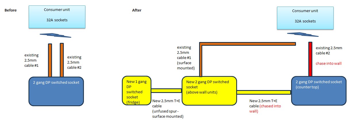

Doing a DIY kitchen refit and currently I only have a single 2-gang socket!
(Small kitchen but that's not enough!)
Just wanted to check if there's any words of advice on my plan below or if I've got it horribly wrong.
1) Add 2-gang DP socket by extending the ring final as pictured.
It's close enough to the existing socket that I can connect the existing cable straight to it.
It will be above the wall units to power an extractor hood and some LED cabinet lights with 3-pin fused plugs.
2) Spur off the new socket, for a 1-gang socket near the fridge.
This is so the fridge's cable doesn't need to go behind/across the cooker!
3) All cables and sockets are currently surface mounted. For the existing countertop socket, I want to sink it into the wall so plan to chase a channel vertically for the existing cables and feed them through an oval conduit, then plaster over. I'll leave the rest surface mounted as they are generally out of sight or use existing trunking.

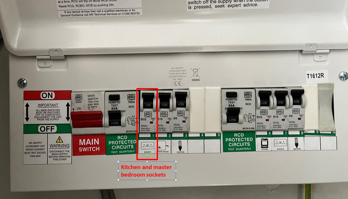

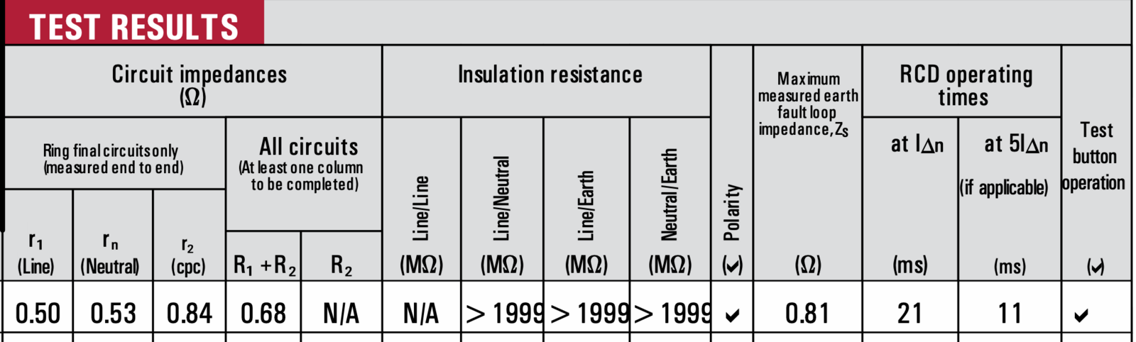

You start with the loop impedance or R1 + R2. A ring final can be up to 106 meters, step one is work out how long it already is. For a B32 MCB/RCBO you are allowed up to 1.38 Ω for the loop impedance to ensure it will trip within the required time with a short circuit.
If you have an installation certificate or an EICR then that should have the info your need.
An electrician will normally extend the ring, he has the testers to know if the limits will be exceeded or not, DIY tends to be the fused spur, as they have not got the test gear required for a ring. The tester like this
with a loop test cost around £40 - £50 and will pass anything better than around 1.9 Ω, a tester like this
will cost around £300 and can measure down to 0.01 Ω and that's the problem, even to hire likely with cost £60 as it needs recalibration after each hire.

So my most recent report when the consumer unit was changed has the R1+R2 on this circuit at 0.68 Ω, if I read the report correctly. I plan to add no more than 3 metres of cabling.

I believe there are 6 sockets on this circuit. It's just that there is only 1 socket in the kitchen itself.
These kitchen sockets are just for the existing fridge, kettle and toaster, plus a new cooker hood (100W) and LED cabinet lights (15W). The only other significant loads would be the hair dryer in the bedroom and freezer/washing machine in the utility room.
