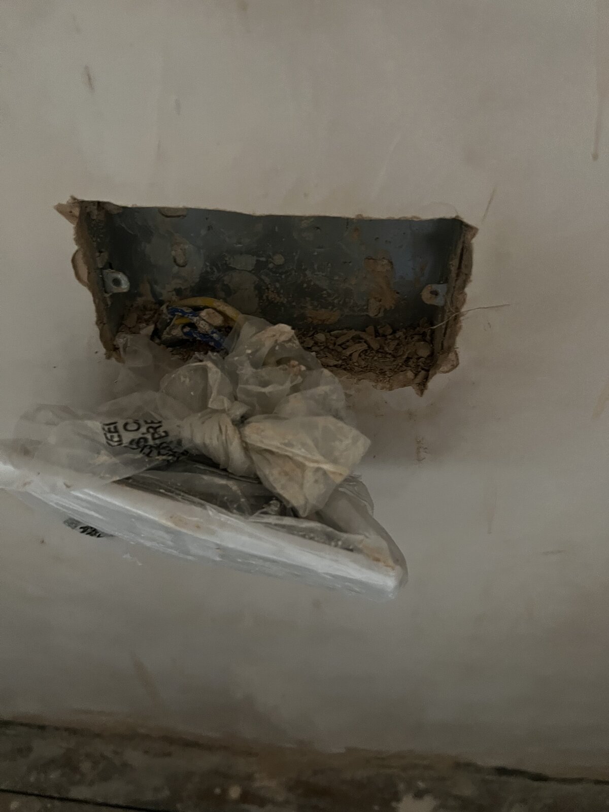

Hi all,
We’ve just finished having our house plastered and the plasterer left all the sockets hanging out in a misguided attempt at being helpful.
Some of the plastering goes over the screw holes so I’m guessing needs to be cut(?) back to show the screws and the socket holes are also filled with plaster.
Clearly I’m new to DIY so I’m looking for some best practice advice of how to make sure the sockets can be screwed back in without damaging the new plaster.
P.S I will turn the sockets off at the fuse board when doing!!
Thanks in advance View attachment 300958

If you have a lot of threads that are full of plaster, a tool like this can help restore the threads:
He should've turned that circuit off, remove the sockets and tape over the boxes.
This would've made his life a lot easier and given a better finish, but hey...
Now, if the plaster is still fresh, you can use a wet cloth to dampen the plaster in the screw holes and use a sacrificial screw to clean the thread by screwing it in each hole.
Or you can buy the tool posted by RandomGrinch.
I think the OP may mean that the plaster extends in to the boxes, past the fixing lugs, rather than the screw holes being blocked.
If so, use an old chisel to gently shave away the excess plaster without damaging the surface plaster. Use a thin nail to remove any plaster wedged in the lug holes. I tend to cut the plaster back flush with the box all the way around, sometimes that is overkill, plastic raised faceplates are more forgiving than the super thin faced metal sockets, which often require a fully cleaned meatal back box.
The plastic plate is 6-8(?)mm bigger than the metal back box, meaning that a parameter of about 4mm will be hidden. In your image it looks like the chip in the top left corner may be visible after the face plate is screwed back on.
I'd recommend buying a small tub of Red Devil OneTime. It is a light weight filler that is easy to sand back. The dust from sanding doesn't become statically charged and stick to everything (unlike powder based fillers).

Definitely get a thread tool to clean off screws holes. Well worth the money.
Any trouble with 3.5mm hole you can get 4mm then use 4mm screws. Saves swapping back box. Just a case of moving up a size and it's an easy job
Thank you all so much, for the advice and the laughs!
Ops was right and it’s that many sockets have the plaster extending right over the boxes but others will need that snazzy tool so I’ll do that too.

Sockets hanging out to allow him to plaster flush with the enclosure. Not refitted, to allow the plaster to harden before sockets are screwed back on. Much easier to remove splatter or intrusion into boxes when the plaster is hard.
