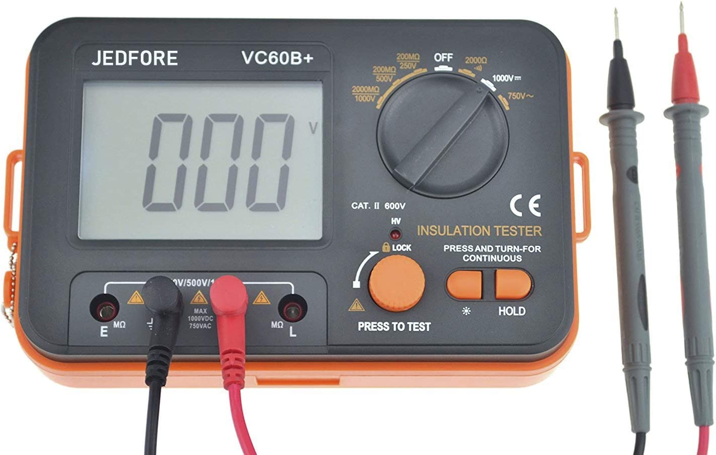

EDIT: This will require the use of an insulation tester. The sort of kit used by electricians.
I'm not so sure about that. At least initial IR testing would do nothing more than to confirm the existence of a fault, without giving any indication where it is.
In the common situation of water ingress, just opening up all the relevant sockets (and other accessories, including ceiling roses) will usually rapidly find the problem (and, usually, also cure it, since things generally dry out pretty quickly once the water is 'released') - but it seems that the OP has already done that, without finding anything, so I'm not sure what's next!
I tend to agree, finding faults without one is not easy, however does not need to be calibrated, so the VC60 costs around £30 so not too bad, I got one when I could not find my Mega, when I did find it reading matched. Only down side is not low ohm range, only insulation tester and volt meter.
In the main faults are caused by water as already said, and if on the neutral load can make a difference.
A RCD tester is rather expensive, and I have had problems where the tester showed A1, but swapping the RCD cured the fault, no idea why, just know it did, both showed same results with tester.

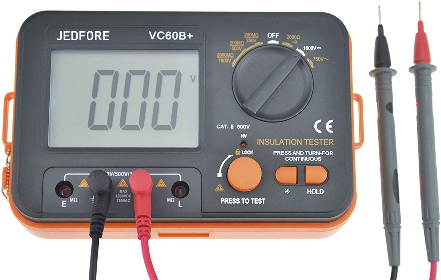

I think this unlikely to be what is going on with you, but it may, so the way to test is to use a meter, first thing is switch off supply with the isolator, not the MCB as they don't turn off the neutral, isolators normally have a red operating leaver, then you test both line and neutral to earth using at least 250 volt, normally we use 500 volt.
Even this is not 100%, as the insulation tester uses DC, and our power is AC, and AC can have inductive and capacitive linking, so we should also test live with a clamp-on meter that the drain does not exceed 9 mA, I have never done this, as my clamp-on only measures down to 100 mA, I have just crossed my fingers.
But I do have an insulation tester, so when I have had a problem, I use that to find out where, I have never needed to use trial and error, we would normally say look for spiders in the sockets etc. But you have already removed them.
I looked at hire charges for an insulation tester, but at £55 per week, and new one for £35 clearly not really an option, a multi-meter is useless to find the fault, so either you buy an insulation tester, or you get an electrician who will have one. So you buy one of these 1659947766248.png or you get an electrician.
The question is if you buy one, could you use it? It does use 500 volt, so quite shocking if you get it wrong, and not sure I could safely instruct how to use one on the internet.
I looked at hire charges for an insulation tester, but at £55 per week, and new one for £35 clearly not really an option, a multi-meter is useless to find the fault, so either you buy an insulation tester, or you get an electrician who will have one. So you buy one of these View attachment 276262 or you get an electrician.
