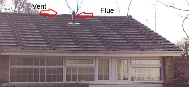

Steve - I had issues with condensation in my attic last year.
I had someone round to inspect the attic and make sure that the insulation was pulled back from the edges of the loft. They said it was and also noted that the main condensation was nearer the top of the roof.
I had a look though and I can't see much light at the edges where the ridge tiles are. So my thinking is that this doesn't seem like an expensive/difficult job so I have nothing to loose by adding more vents.
You can see the ridge tiles on this photo attached.
(ignore the arrows they are pointing to something else)
I've also cut down on the moisture I create in my house and I'm planning on getting an extractor fan in the bathroom. I'm hoping after all this my condensation issues will go and I won't need to get a roofer in to add tile vents.
If what I'm about to do is bad idea let me know though
Cheers
I would have thought that potentially it could lead to problems in the winter, potentially pipes could freeze?
Just a thought.
