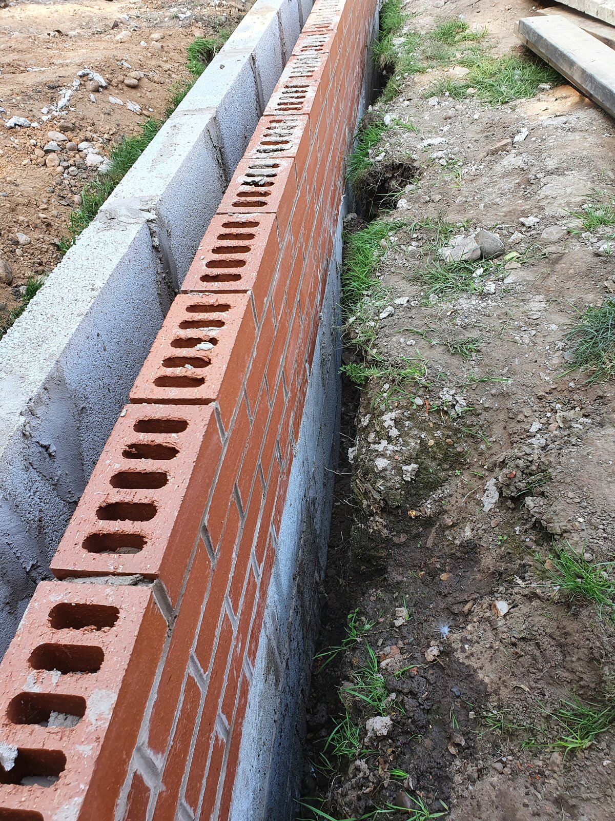

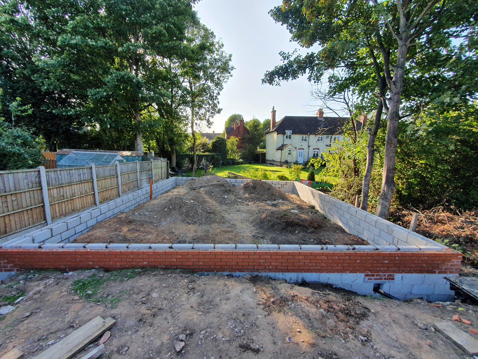

So i wasnt meant to fill in the trench with the same stuff that came out of it?
Trench? You're not putting hardcore under foundations are you?
No - as in filling around the edges with the dig out soil after the dpc blocks were laid....the hardcore will go on top of the soil.

Oops I misread the OP, no you don’t whack soil. Yes it’s ok to backfill the trench with soil. Yes the hardcore will reduce in depth a little bit as you whacker it. Can’t give an exact height it’ll reduce by though.
Thanks :) thought i was going down the wrong track then
